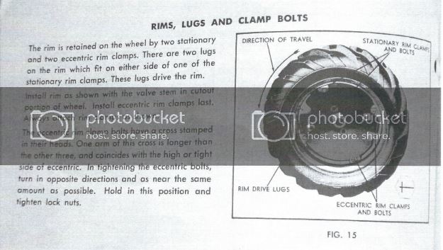

step by step to make it easy with 2 plain clamps and 2 eccentric clamps' I know In need the 2 eccentric bolts and locks next to each other.

It's in the operators manual. First the 2 solid clamps MUST be beside each other. Also 1 of the solid clamps MUST bet engaged in the drive lugs of the rim. Then the 2 eccentric clamps go on and get tightened up.
   If you have a bent trim that won't tighten up this way, replace the 1 solid clamp that is NOT in the rim drive lug with an eccentric clamp.

I install the two solid clamps at 10 and 2 o'clock position.... have a jack under the drawbar area... roll the tire up to the hub and get the BUMPS lined up.. have the tractor/ clamps 1/2 inch lower than the rim/tire... roll/ tilt the rim/tire OVER the two clamps ... jack the tractor up and inch so the rim is HANGING on the two clamps... install the cams in the BOTTOM two positions... rotate the cams and tighten all.
no lifting at all........ easier than putting a 15 inch tire on a car.

    My memory returned before I read your how to post. The difference in my rims and clamps is NO BUMPS. My rims and clamps are the older, correct for 38 and 39 Bs, used between the very early split rims and the bump rims using the 5/8ths bolts.
     The clamps have feet that fit over short angles riveted to the rims . Looking real close, one of the angles is stamped with the word FIRESTONE. The bolts are 3/4.
    I bolted the plain bolt clamps at 10 and 2 at the top with the clamps on the inside and hung the rim on these two clamps. Next. I fit the eccentric clamps at the bottom and snugged everything up tight.
