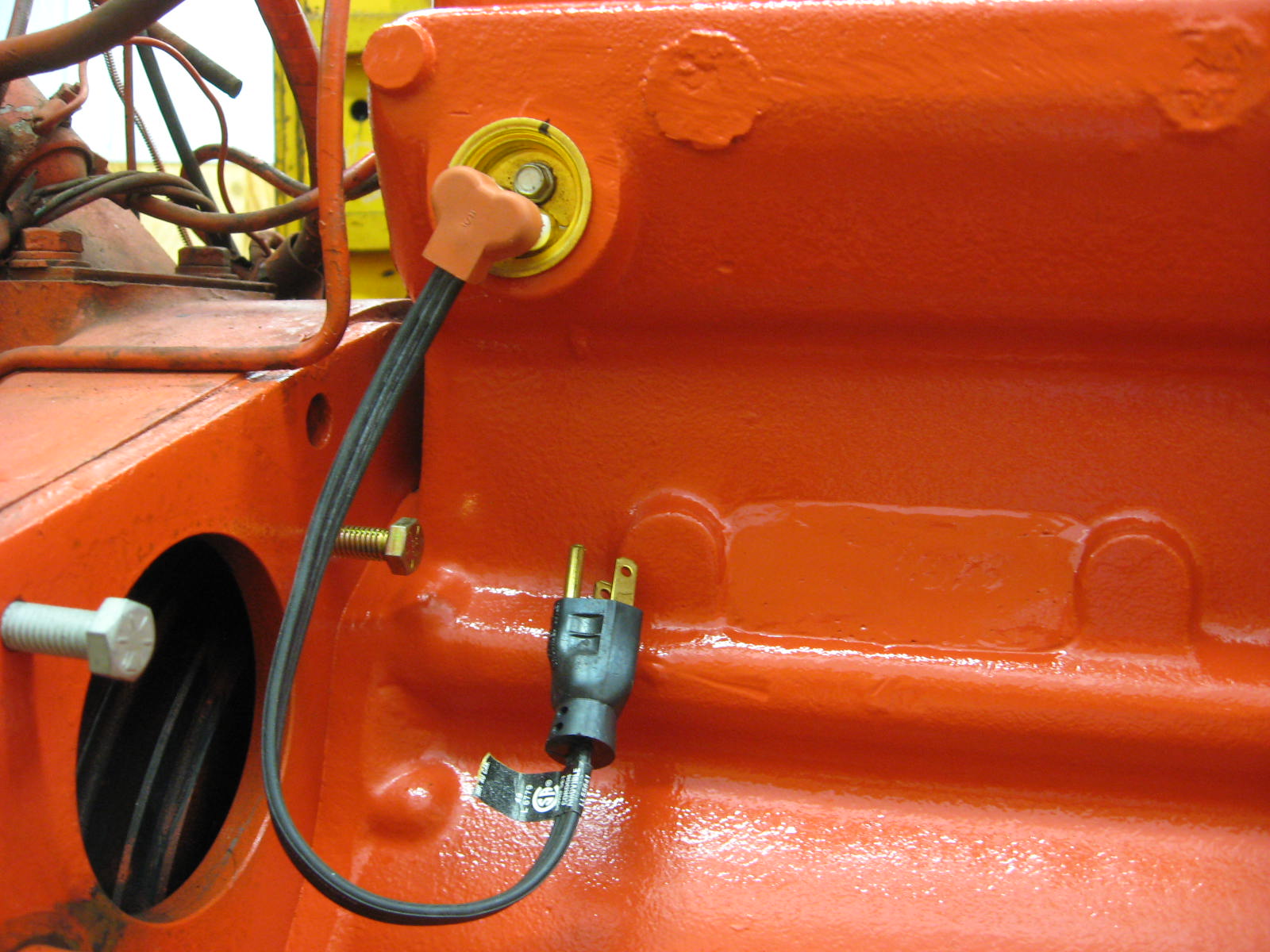

Here is a long post I submitted related to installing a block heater that I did last year in my 190xt.  My 190xt is around 1968 and did not have the easy flange plate.  I knocked the frost plug out above the starter and installed it.  I ended up using the ZeroStart model with success.  My install still hasn't leaked after almost 1 year and I love plugging it in for about an hour or two and fires right up.  Good luck and hope you learn from my mistakes and issues.

I recently installed a Kat's P/N 11618, 600 watt, 35mm frost plug heater on my 1968 190XT.  I made the butterfly wings as narrow as possible, lubed the o-ring, inserted the element at about one o'clock and torqued the machine screw to 15-19 inch pounds. It was a nice snug fit w/o any modifications. I didn't like the five foot cord that came with it, so I bought a Kat's P/N 28201 one foot cord. Be sure to use some very fine sand cloth to clean up the hole where the o-ring seals. Around here, Auto Zone has it listed for $25 on line.

Ok, thanks guys.   This is the kind of heater I'm looking for.   I will have to order one when I get a chance.   Busy combining now.
