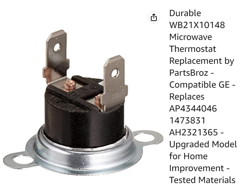

I have had a couple of these temp switches crap out..They get HOT and open circuit, then will not reset... check continuity, or just jumper the two wires together to test.
