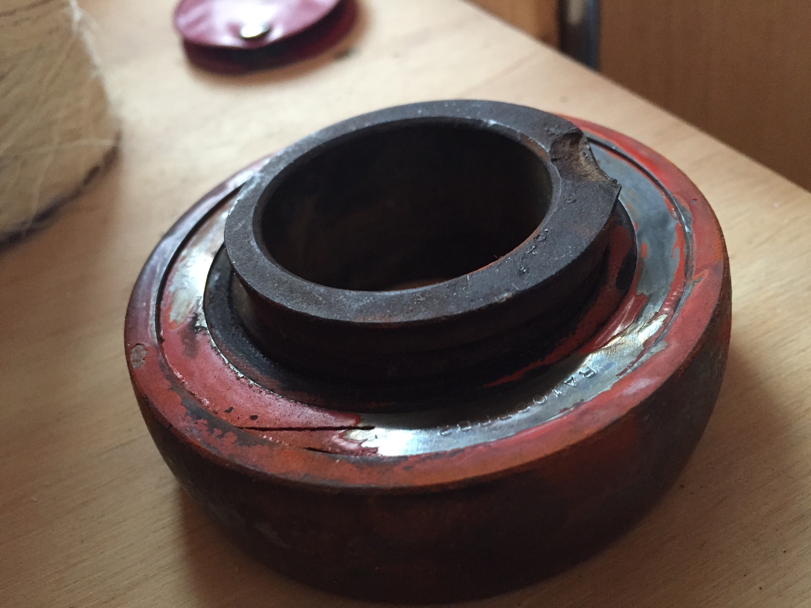

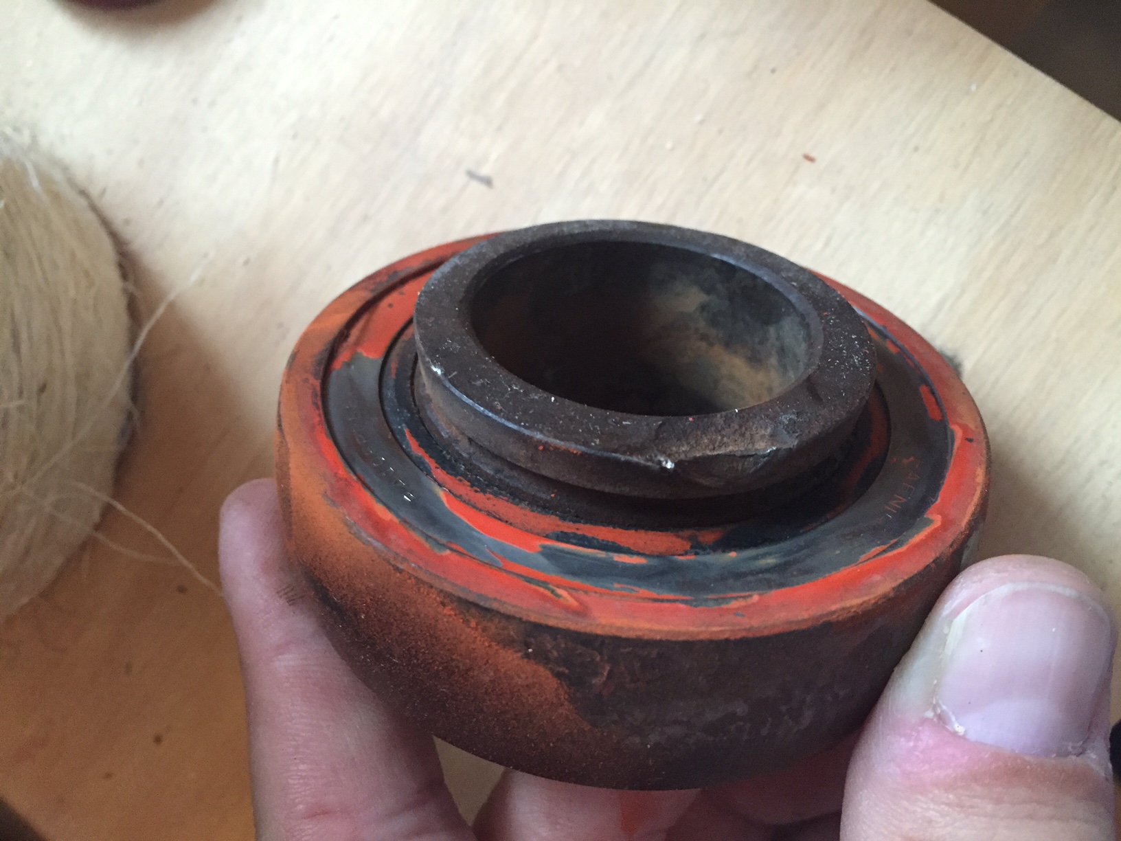

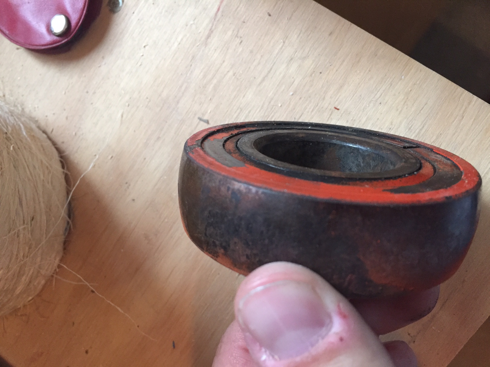

Here are some pics.  I took some dimensions and this is what I found:
ID 36.15mm and 1.423"
OD 79.98mm and 3.148"
bearing thickness (not including locking shoulder) 22.2mm and .874"
bearing thickness with shoulder 30.25mm and 1.19"
I also found another place where the bearing number was stamped and it is definitely a FAFNIR bearing and the number is definitely RA108PPB2
Edited by rlrobinhood - 14 Jun 2016 at 10:00pm

Look for fafnir #muob 1 7/16 bearing. Has 1 7/16 bore with 3.1496 od. Listed as a medium series bearing for straight shaft mounting with spherical od.

I thank that is a spherical bearing that goes in a pillow block bearing.Look for some one that sell millwright equipment.

I can't tell from pic if od is cylindrical or spherical. If od is flat across then the # is muoa 1 7/16" if it has a radius across then the # is muob 1 7/16". Check with any bearing supplier should be able to supply.

Hi TMiller/NC.  I havn't found the bearing yet.  only one side has an extended collar and the OD of the bearing is spereical and goes into a pilblock.
I did order a bearing from AGCO that I'm expecting any day now.  I'm hoping its the right one.  Otherwise, I'm out of luck.  But, my fall back plan is to take a bearing that has an extended collar on both sides and turn down (remove) one of the extended collars.
