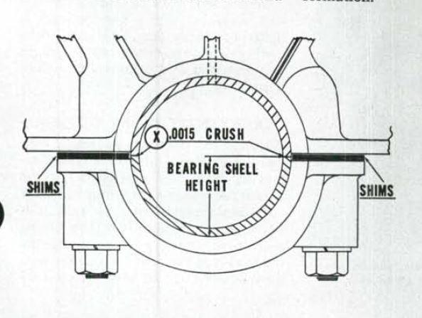

I'm a bit confused after reading through the manual on setting the crush height of the crank bearing shells.  For a crush amount of .0015", does that indicate .0015" protruding on both ends of a bearing half?
And also, should there be "crush" showing on only half of the bearing i.e. the half installed in the block has crush, but the half in the cap is flush?  If I install a bearing cap, should I see the crush gap at both sides, or only one?
What is the best way to measure the total crush?
Lastly, why does the manual say "for each .002 reduction in height of a pair of shell inserts, remove a .0025 shim from each side"?  Why isn't this a one to one relationship?
This is for a '49 C (if it matters).  Manual seems to indicate this was common across models.
Hopefully the questions make sense!  thanks

Post Options Post Options   Thanks (0) Thanks(0)   Quote Luke114 Quote  Post ReplyReply Direct Link To This Post Posted: 12 Nov 2019 at 11:32am
Thanks for the responses, guys.  I probably made my question overly complicated, getting crush and clearance conflated.
In this picture in the manual they show .0015" of crush on both sides, but I think a normal way of measuring would be with one bolt torqued up and the other loose, or just snug as Dick L said.
So should I look for .0015 gap on both sides or just one?

Post Options Post Options   Thanks (0) Thanks(0)   Quote Dick L Quote  Post ReplyReply Direct Link To This Post Posted: 12 Nov 2019 at 11:51am
It would be both sides to be sure you didn't have one side at .0015 and the other at .003 or something. I actually make one side flush in the rod and one end flush in the cap and measure the other end with a feeler gage using my finger to feel them flush. When torqued against the shims it will center the bearing shell.
