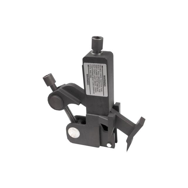

Kid down the road has a neat bead breaker.. dont know what its called but it clamps to rim and expands as you tighten a bolt on it with a socket wrench. works quite well but when I went to buy one for myself it was very expensive.
R.W View Drop Down
Joined: 31 Dec 2010
Location: Swanton, OH
Points: 2975
Post Options Post Options   Thanks (0) Thanks(0)   Quote R.W Quote  Post ReplyReply Direct Link To This Post Posted: 09 Jan 2012 at 1:45pm
Does it look like this?
