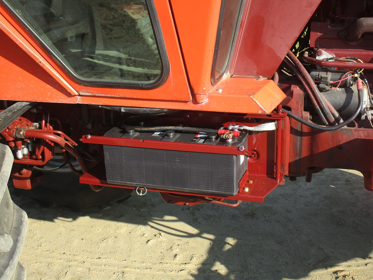

Post Options Post Options   Thanks (0) Thanks(0)   Quote Tim NH Quote  Post ReplyReply Direct Link To This Post Posted: 27 May 2023 at 6:55pm
So in February both batteries charged right up in a couple hours. Then in March the back one, the one that took so much water, wouldn't take a charge after a day and a half. So I took the tender off it, and load tested it. It went from weak to dead. So I took Curt's advice and put in a big battery. I'll use the other battery on my tractor diesel fuel tank pump. Thanks Curt, and you other guys too.

Post Options Post Options   Thanks (0) Thanks(0)   Quote Lynn Marshall Quote  Post ReplyReply Direct Link To This Post Posted: 31 May 2023 at 6:53am

Post Options Post Options   Thanks (0) Thanks(0)   Quote WF owner Quote  Post ReplyReply Direct Link To This Post Posted: 31 May 2023 at 7:10am
It looks like the same setup as mine was. If it is, there is actually more clearance (between the battery and lynch pin) than it looks.

Post Options Post Options   Thanks (0) Thanks(0)   Quote Tim NH Quote  Post ReplyReply Direct Link To This Post Posted: 31 May 2023 at 7:55pm
Thanks for the compliment Lynn. I checked the clearance today. There's a lip around the bottom of the battery. So I have to push the pin up a little over a 1/8'" before it touches the battery. I enjoyed doing that project. The hardest part was getting the hinge rod out, so I could get the tray sand blasted.   Tim
