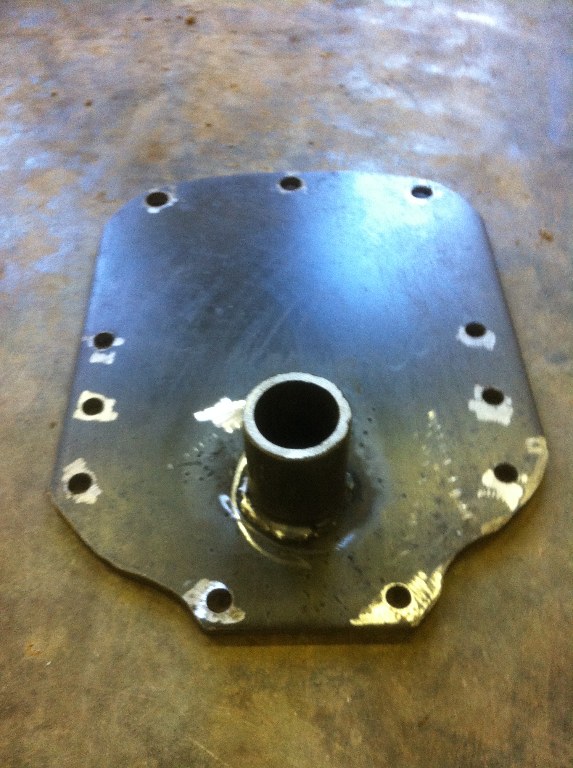

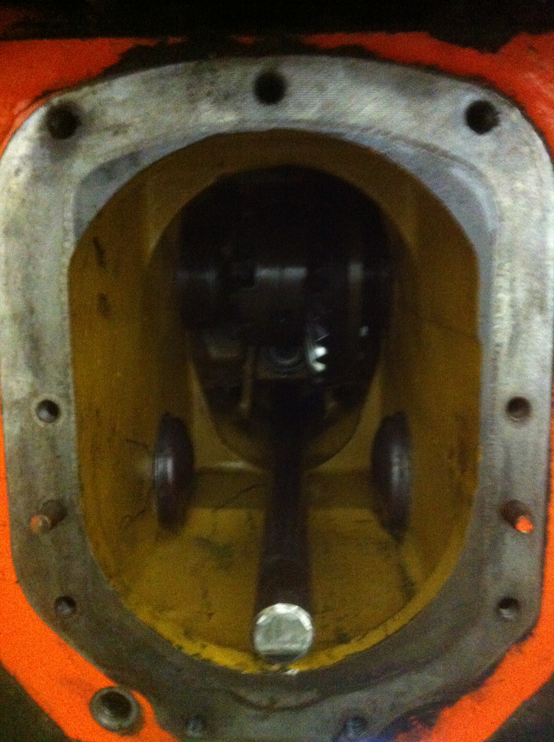

Here are a few pics from me making my 190xt bareback.  Made a cover plate and a support for the PTO shaft.  (Had to sacrafice my old pto shaft by shorting it)
Its hard to see, but it does have the 4 pinion differential in there.Smile

Good job, should work! Tap those axle caps while its apart make sure they are tight, they do pop off sometime

Yup, I checked that.  I also stuck a large magnet to the bottom of the housing to help attract any metal particles.

It will transfer oil from rear to frt and back.  You could pull shaft out and put freeze plug where seals are to stop oil transfer.

Yes. It will mix hyd oil and rear end/Trans oil without something in there. It was just easier to cut the shaft off and leave it in there than to come up with another way.

If I ain't mistaking can't you pull the shaft the drop the pto box and put a freeze plug in from the front

See how much room there is in the pic from the diff to the plate your goin to instal. Put jugs in to take up room it will take less oil. Just helpin to save weight while your already there.
