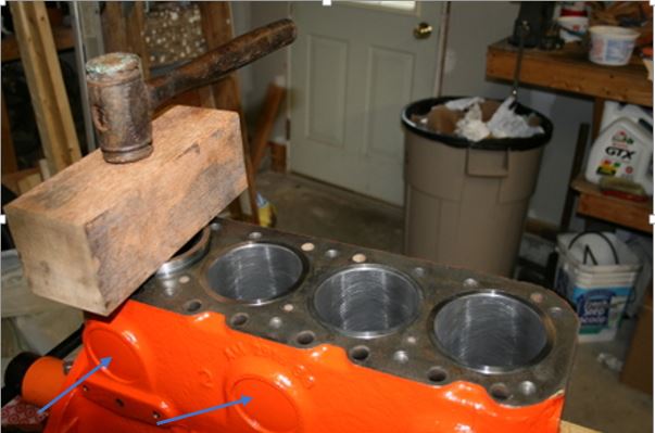

Any decent ag dealer should have some imperial freeze plugs if not get them off ebay

Agco # 70203093 1.250 Cup Type
mdm1 View Drop Down
Location: Onalaska, WI
Points: 2720
Post Options Post Options   Thanks (0) Thanks(0)   Quote mdm1 Quote  Post ReplyReply Direct Link To This Post Posted: 21 Mar 2019 at 12:21pm
Take an old plug with you.

Alvin unfortunately Agco part no,S are of no use in the uk but the size will work.

So that’s 1 1/4 “
That picture makes it look obvious but my one had no apparent hole or fracture, it was thin and well rusted underneath though.
It had obviously failed though as each time I soaked the water up with a rag it filled again but it literally looked like magic. I know how daft that sounds but just couldn’t see where it had failed.

# 70203093: 1-1/4" core plug = 1.13" ID, 1.26" OD, .33" deep (info I found on line) 1.260" is a standard OD for 1-1/4" cup plugs.

That is the oil galley over the lifters behind those core plugs. If you have a need to remove them hit them hard in the center to cave them in some and they will fall out. Take one to NAPA and they can match them for you. They are a common plug NAPA has in stock here in my area.
