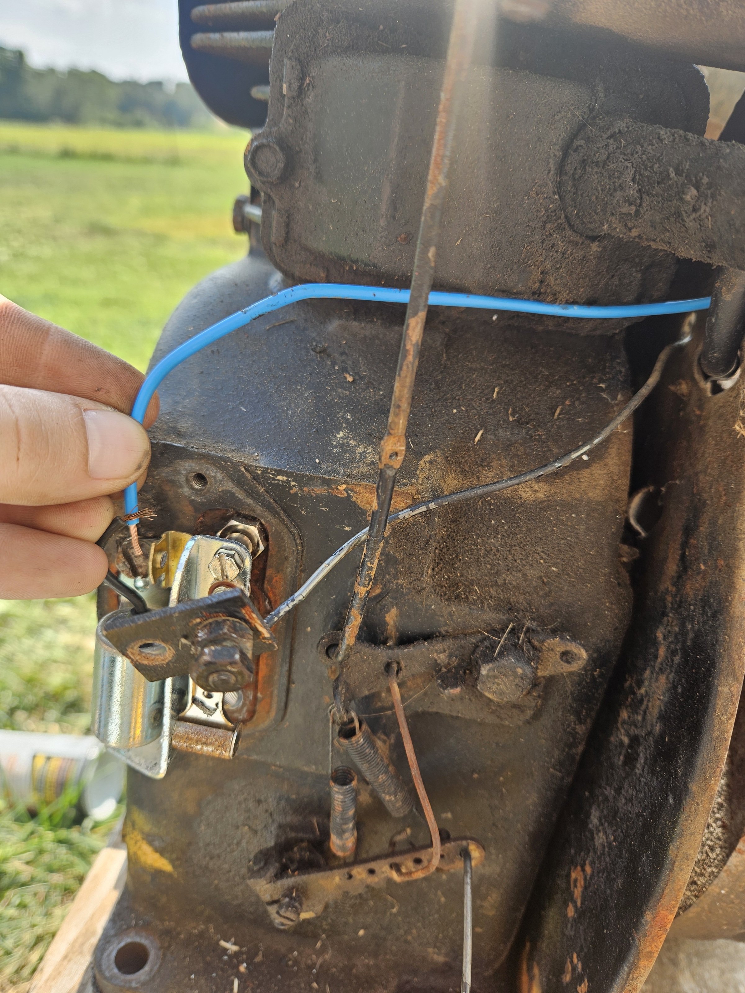

Post Options Post Options   Thanks (0) Thanks(0)   Quote acken Quote  Post ReplyReply Direct Link To This Post Posted: 13 Sep 2024 at 8:07pm
Assuming that blue wire in picture goes all the way to the insulated coil wire, you will not have a way to shut it off. If you want to leave it that way for testing its fine. Eventually you will want to hook blue wire to the screw on the insulated tab outside of the point cover (in order to complete circuit to ground when you turn key off). The air gap between coil and magnets in flywheel should set at .012". Best way is if you have 2 of the correct size feeler gauges, on under each leg of coil. Line coil up with magnets, then tighten screws.

Here's how I have it set up
Going to check timing of the points breaker opening up in reference to coil and magnet on flywheel I do have a old manual for setting up the timing so that should help me there.as long as my wiring setup is correct

Post Options Post Options   Thanks (0) Thanks(0)   Quote Tmr17563 Quote  Post ReplyReply Direct Link To This Post Posted: 13 Sep 2024 at 12:57am
The stud looked like it had other wires connected to it I figured it was a ground so I extended the wire and ran it right to where the points breaker goes there's a stud inside where the condensor wire is I figured they had to be connected (totally new to the older engines) as far as I can tell this is original to the tractor

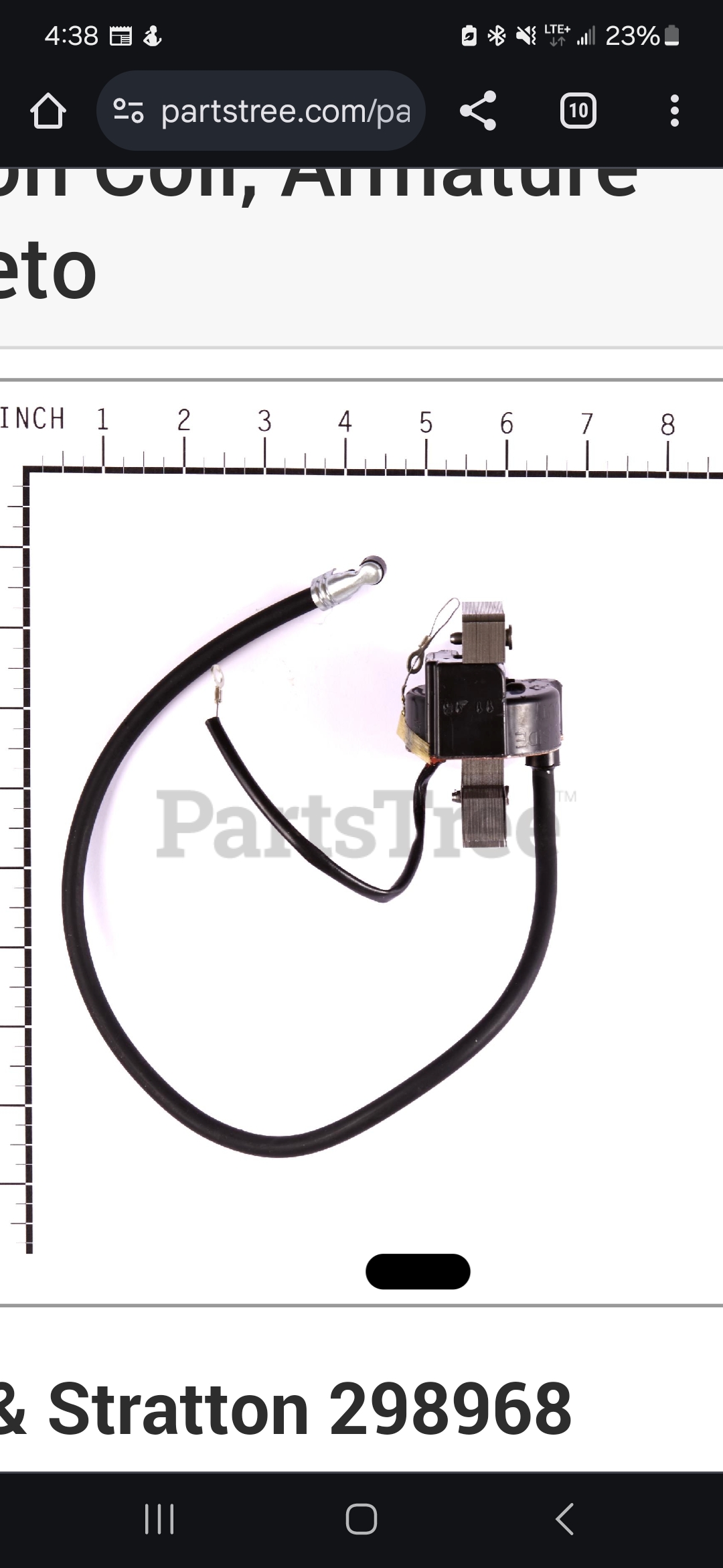

Post Options Post Options   Thanks (0) Thanks(0)   Quote acken Quote  Post ReplyReply Direct Link To This Post Posted: 12 Sep 2024 at 9:07pm
The small wire with the black insulation would go to the insulate stud above and to the left of the actual coil. Verify that stud still has the insulation to keep it from being grounded. I will try to get a pic showing an original in place. Is that the original engine, not a replacement that could be newer with electronic ignition (has actual breaker points/condenser)?

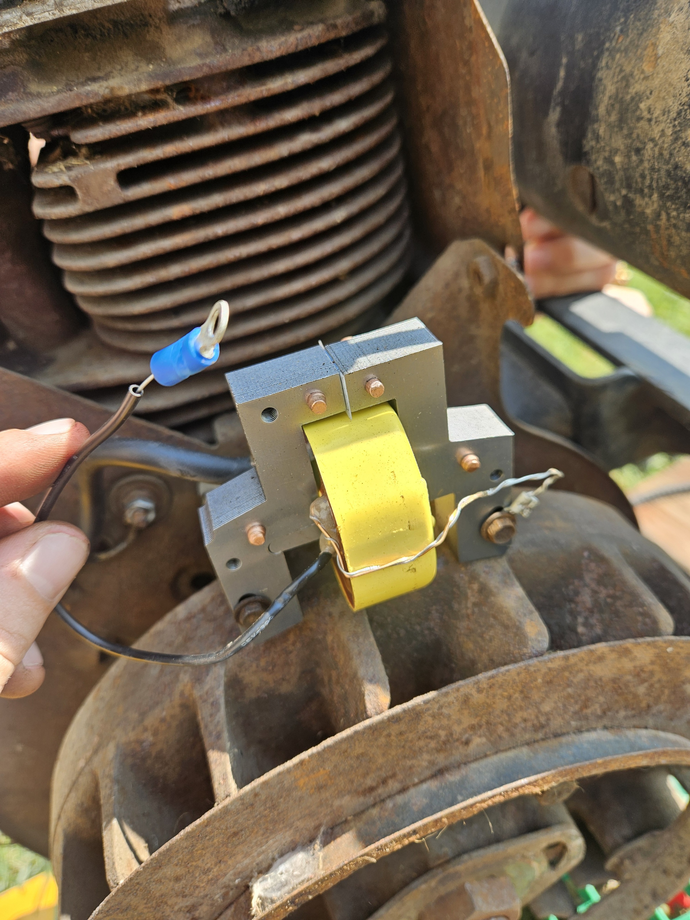

That's the coil I bought for it the smaller wire was on one of the bolts for coil black wire I assume goes to points?

I'll check it this morning the coil had 2 small wires that were bolted to where the coil mounts and the longer black wire that goes to the points so I'll go through it. The two smaller wires can they bith be grounded at the same spot or do they have to be separate?

Post Options Post Options   Thanks (0) Thanks(0)   Quote acken Quote  Post ReplyReply Direct Link To This Post Posted: 11 Sep 2024 at 9:08pm
That ignition system is grounded to shut it off. Any bare spot between the junction down at the points cover can kill your spark. When you replaced coil did you make sure small wire from coil going out to points had not rubbed through insulation? A good way to start is remove the wire going up to key switch, that will take that wire, and the switch out of the equation. If it happens to start you will need to ground out the spark plug, or ground from the connection at point cover.
