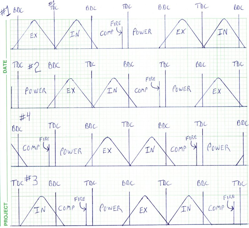

Is this just a bizarre coincidence, or did Allis-Chalmers actually go to the trouble of designing a camshaft with different patterns to compensate for the weird firing order of their engines which causes disruptions in the induction system due to the overlap events?

I was hoping that someone with more knowledge of these engines would chime in with some further insight on the apparent anomaly in the cam timing.
Both end cylinders have shorter net exhaust duration and longer net intake duration.
Both middle cylinders have longer net exhaust duration and shorter net intake duration.
It is difficult for me to believe that this is not by design and merely an accident from wear.

  My guess it a coincidence of wear, I cant imagine AC would have taken the time or money for R&D on a mass produced engine.

the numbers Les measured dont seem to show much wear.. LIFT is all very close... Hard to tell if it was really DESIGNED that way... or the manufacturer just had an OOPS in the setup... Maybe happened and not really designed ?  ... Dont think the COST would be any different once the setup is done..

That was certainly my first thought as well. I did some searching and found an old post in which DrAllis states that the WD-45 does indeed have a dual-pattern camshaft, so it is evident that Allis-Chalmers did do some research on that engine and saw a need to go to the extra effort. Of course that does not mean they put the same effort into the B-125 engine.
... Duration on a stock WD-45 camshaft is 210 degrees intake and 220 degrees exhaust. A 175 grind is 230/230 duration...
I also found a thread on the Pulling Forum with some rather lively discussion about camshafts; forum member wi50 wrote an excellent description explaining some of the design issues with the Allis-Chalmers 4-cylinder engines due to their peculiar firing order.
Originally posted by wi50 wi50 wrote:
That answers a lot. If you were to call isky and send them a cam you would not get anything like that grind for a flat plane, 180* Siamese port engine like this...
The way these engines are configured limit the available time we have available for the induction events. An engine with individual ports can tolerate more duration. A 6 cyl Siamese port can tolerate more duration. But a 180* or flat plane crank simply can't. You see there is overlap of the intake and exhaust valves, then there is overlap of both intake valves on a port at the same time that one exhaust valve is open......you wind up with 3 valves open on 2 cylinders opened together. In a sense, to much duration will "airlock" the engine to where it's not going to run well at all.
If you were to call any reputable can grinder or designer, you will get the same story.
The way these engines are configured with the flat plane 180* offset crank and the Siamese port it is hard to run much duration. If it had individual ports, you could. If it were a 6 cyl inline you can run more. But anything much more than the mid 220's @ .050" isn't going to work.
In an effort to wrap my feeble brain around all this, I mapped out the camshaft events on my B-125 engine as follows.
I used the 0.010" lifter rise values.
Edited by Les Kerf - 22 Feb 2025 at 10:01am
