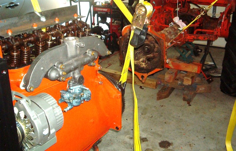

Here is a rough overview of the procedure-  You only need to split the tractor at the torque tube to transmission location to change the trans seal.
You will need to support the rear end under the drawbar and under the front of the transmission.
Look at your tractor and you will see the only thing keeping the engine from flopping over on its side are the bolts from the torque tube to the transmission.  If you remove those bolts the engine will flip over and you will have a mess.  So you need to secure the engine and torque tube in an upright position by means of straps off each side of the torque tube by the clutch housing or by fabricating an attachment which bolts to the rocker arm studs (see pic). The easiest is to drill holes in a section of angle iron and lift the engine with an engine hoist, then you can separate the torque tube from the transmission and walk it away.
Changing the seal is easy, unbolt the seal flange, knock it out and drive in the new one, then bolt it back up to the trans.
Bolting the torque tube back up was not that difficult, just some alignment
Be safe with this procedure.  You should refer to the Maintenance manual for exact steps.  Probably be easier with two people.

No, you only need to split the torque tube from the trans to replace the seal at the front of the trans.  I was changing the entire torque tube, hence the double split.
Look through Dick L's site here to see how to do it with an engine puller- look under the engine rebuilding album I believe.
