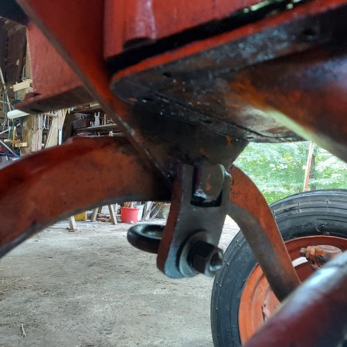

Steve in NJ: I unbolted oil pan, but could not drop it.  Will need to remove WFE bolt and cut off a welded-on front tow bracket (see picture) to get the oil pan out.
