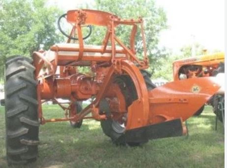

Anybody know about these plows

what exactly are you trying to find out ?

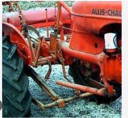

does some one have pictues of the mounting in the front

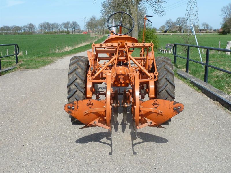

Hud... most of the plows just have a PIN hitch at the front.. It pins to a horizontal bar running side to side in front of the wheels. ... the bar is attached to two pivot arms and the bar can be raised or lowered with a hand lever that comes up by the gas tank.. Look at the photo above, and this one below..

My Dad bought a new "B" with the 2-way plows in (I think) 1941.
The plows were hydraulic lift.
In addition to not leaving a "dead furrow", the plow not being used added weight to the wheel traveling on the sod.

i have the two plows and all of the stuff in the back , but i am missing that front piovot and the helper spring but i do have the up down hight lever it came with two parts b's that i gotwould like to get mine going for the c
