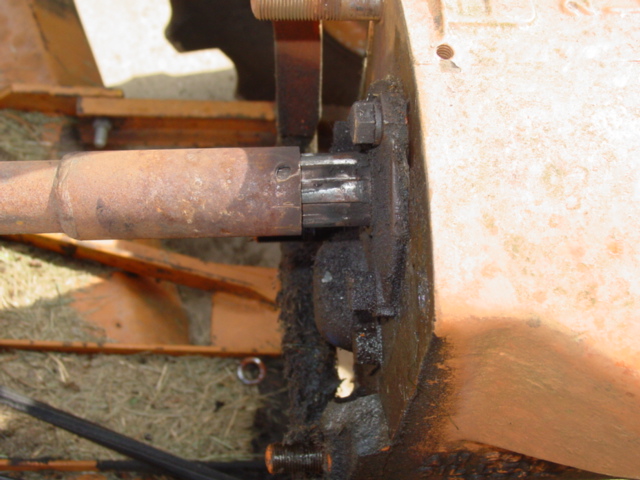

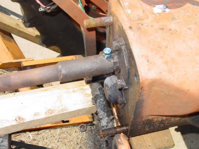

I think I broke my torque tube last week by using my loader to remove it after I had the engine removed from the front. Here is some pictures that might help.
They have to match the splines and have a cotter key. I drilled this one out and put a 5/16" grade eight bolt with a double nut. I have changed several and used a cotter key without a problem. The drive shaft splines can get damaged when not fully engaged and held with a cotter key.
