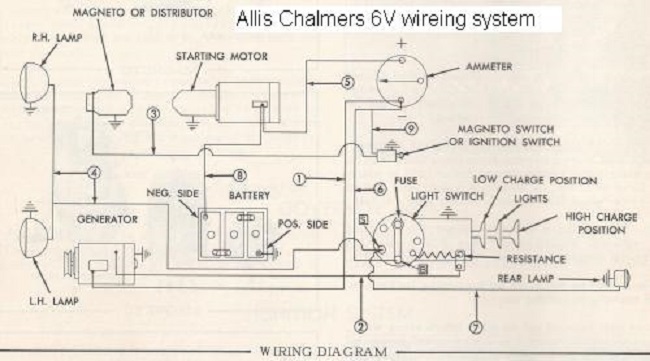

Since you are 12v, you dont have the ORIGINAL light switch... You would just use a toogle for the NEW lights... Here is an ORIGINAL drawing showing the ONE WIRE FEED..

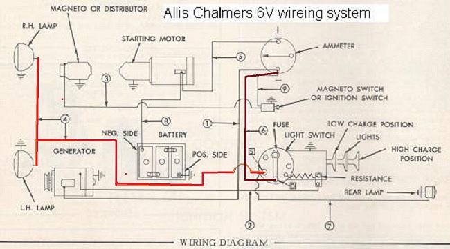

yes, you could use the ORIGINAL switch just for the lights.. The ORIGINAL switch will have a couple more terminals on it and a resistor as it was used to regulate the current output of the old generator... It will have 3 positions... OFF, LOW, HIGH... you just need to pick a couple terminals to just turn the lights ON in one positons..
You would run one wire from the amp meter to the light switch ( shown in brown), and one wire up to the lights ( shown in red).... the 3 positions switch would only work when pulled to the middle LIGHT position.
