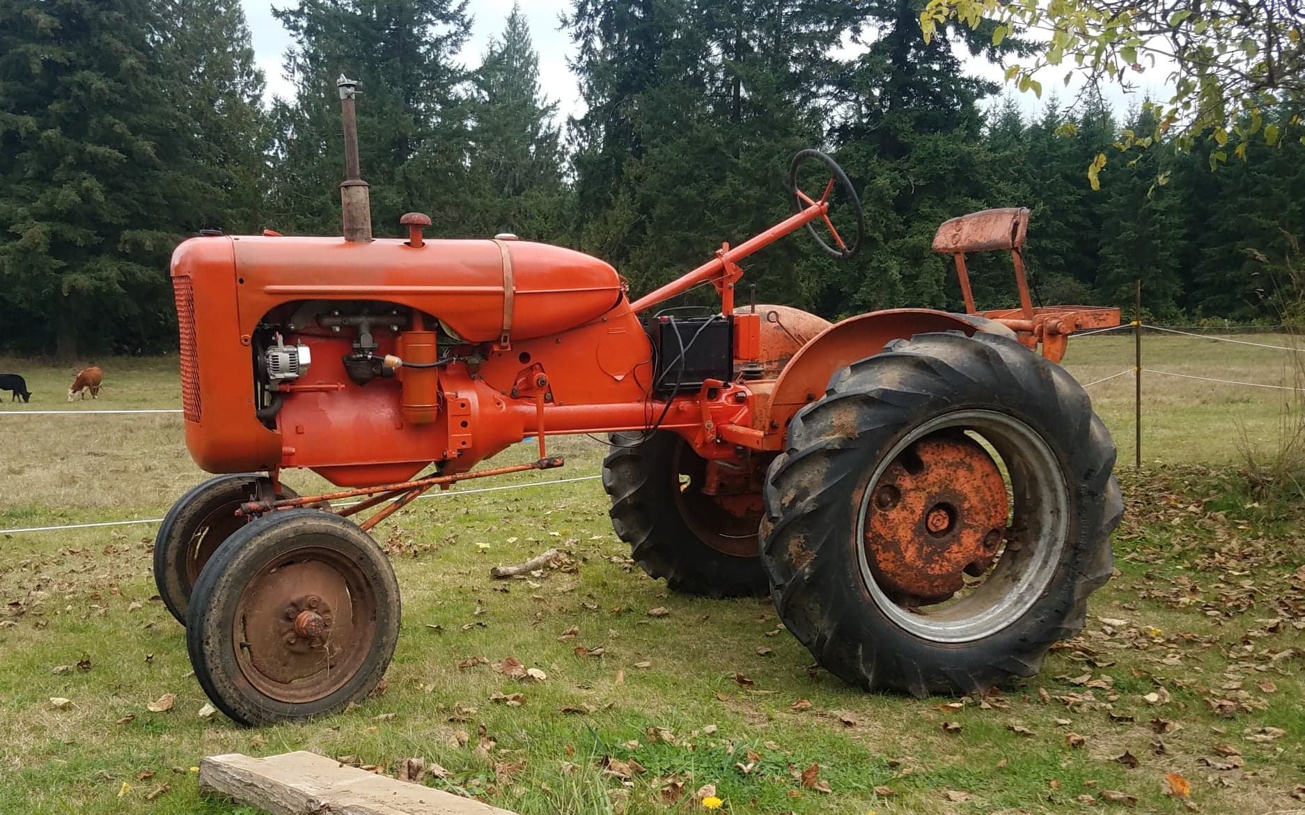

Getting close to having 2/3 of the tractor done.  Wiring yet to do, and some front tires on order.  Paint definitely needs some touch up.  The starter grinds instead of engaging the flywheel about half the time.  The ring gear has some wear, but its not awful.  Is there any other starter inspections/adjustments I should look at before starting to replace parts?
The original push button contactor on the starter was shot, so I added a remote start solenoid, and running on 12 volt.

Replace your ring gear and have the starter rebuilt as a 12volt unit. This slows down the RPM of the starter and will not tear up the ring gear.  Yea everybody, there are hundreds people that have 6 volt starters running on 12 volt for years without a problem, however this is the other side of the coin.  Doing the job right will make it last your lifetime.

At a minimum, convert starter to 12v (if it isn't already) and plan on replacing the bendix.  Amazing what a new bendix can do.

Paul is right on the money. Running 12V's through 6V field coils don't cut it. Makes the Starter motor violent. Cracked nose cones, worn out ring gears, and bent drives are just a few of the complications of that situation. I completely rebuild these Starter motors including a rewound Armature if interested. I also add a HD Starter relay so the unit gets full power and has a nice transistion to the flywheel ring gear. Eliminates the old rod n' switch issue also. Installing a key crank start Ignition switch takes that Model B out of the 40's and puts it in the 60's.  If you need a wiring system, I build them to. Visit our website. There's lots of information on 12V conversions and the do's and don'ts.

Thanks for the input, guys.  Last night I pulled the starter out of the C and tried it in the B.  Huge improvement, no grinding and sounds good.  Hadn't really noticed how bad the starter pinion gear looked until comparing it to one that wasn't worn out.  The C is still a salvage project and I hate robbing more parts, but looks like this will get me by for now.  Also built a hand crank last night and started it a few times that way...just in case.
The flywheel ring gear is still not in great shape, but I think the majority of the problem was the pinion.  Thanks for the tip on flipping or rotating.  I didn't realize that was an option.
Point taken on the 12 volt conversion at the starter.  I suspect that is the correct way to go, but it will have to go on the wish list for now.  I converted to 12 volt because the generator needed a complete rewind and the mini Desno alternator was cheap and easy, along with the idea of eventually getting some LED lights.
