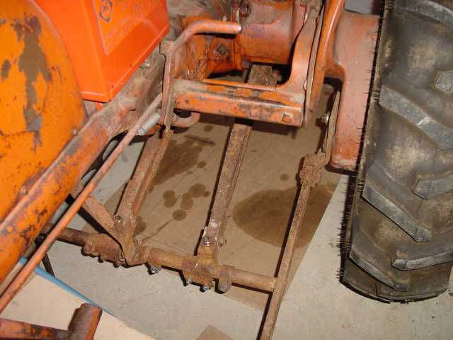

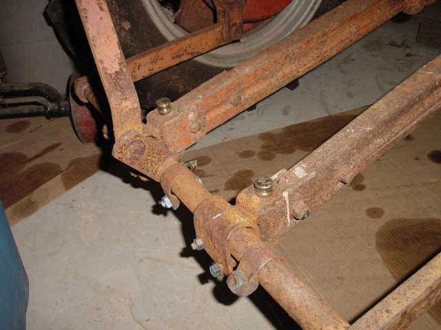

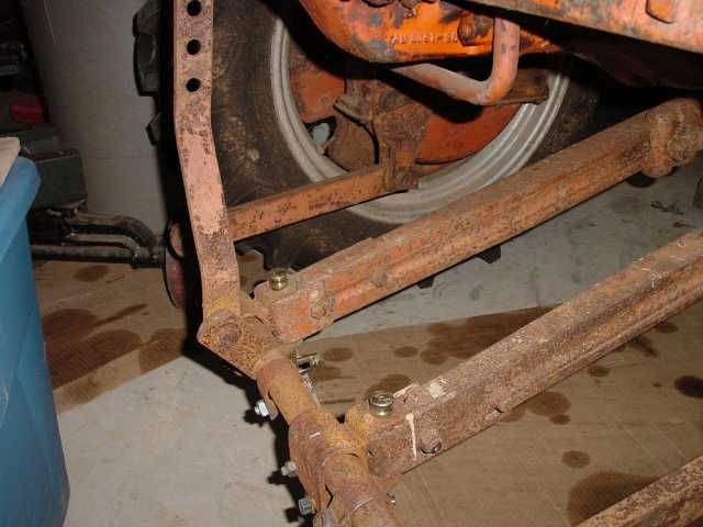

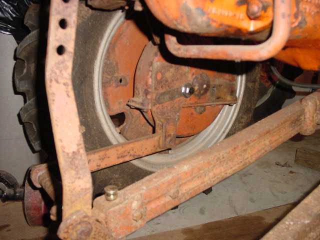

      Im trying to install my rear manual lift for my right and left plows .Does any one have a real close up picture of how they mount  to the back of a B or C   so i can get them hooked up?           thanks RON nca

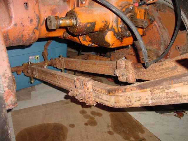

I've been trying tp upload pics of mine, but the site won't let it happen. I'll try again tomorrow.

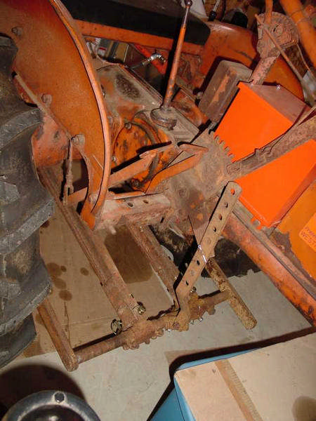

Here's a photo forum member WC7610 sent me that might help...
'41 C w/Woods L503 mower, #3 mower, 2-way plows for C

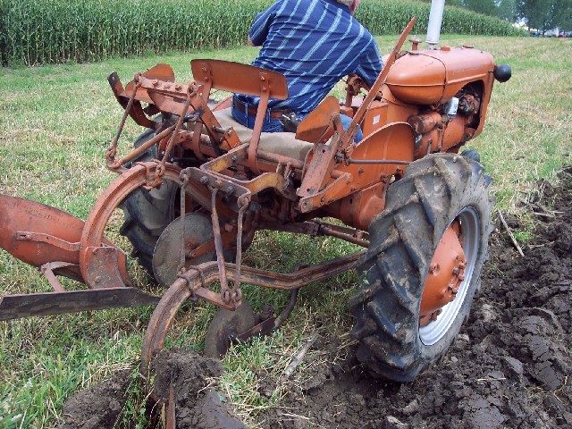

Is the selection of right or left done mechanically? would there ever be a need for both plows down. I'm not a farmer, just curious.

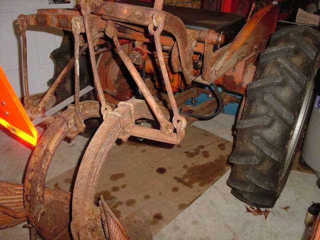

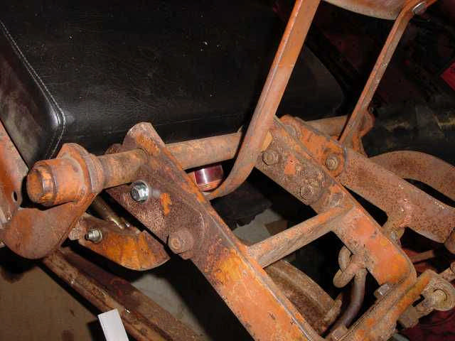

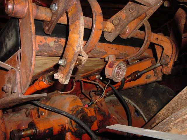

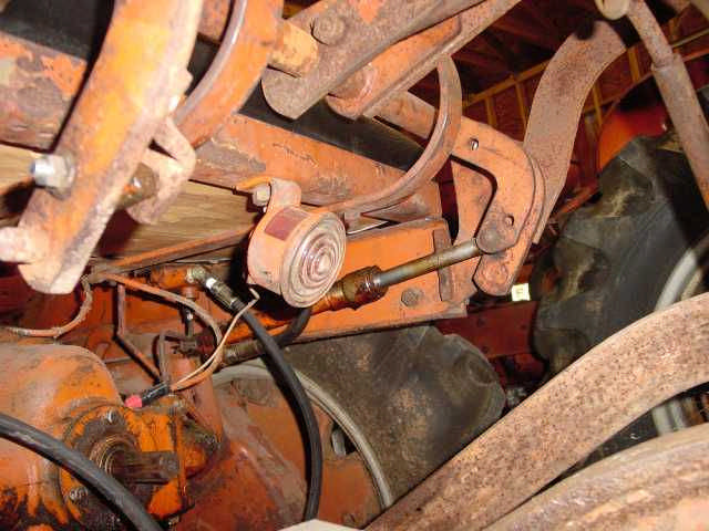

Here we go.....
Edited by JohnCinMd - 15 Jan 2012 at 12:31pm

             Thanks guys i think it will help alot an no you dont have them both down at the same time it just helps so you dont have to go around an start over .
