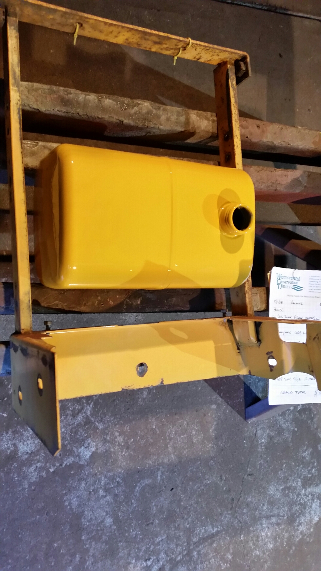

For anyone who may be interested here is a ppg paint code for the 200 series tractors. PPG code 944133. The code was obtained by a computer/camera color match from the interior of the grille support. The code is one of the new lead free formulas and is available in omni acrylic enamel and omni basecoat. The tank is basecoat with ppg high solids clear.
