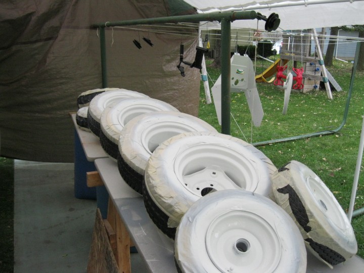

For the white I used "Winter White"

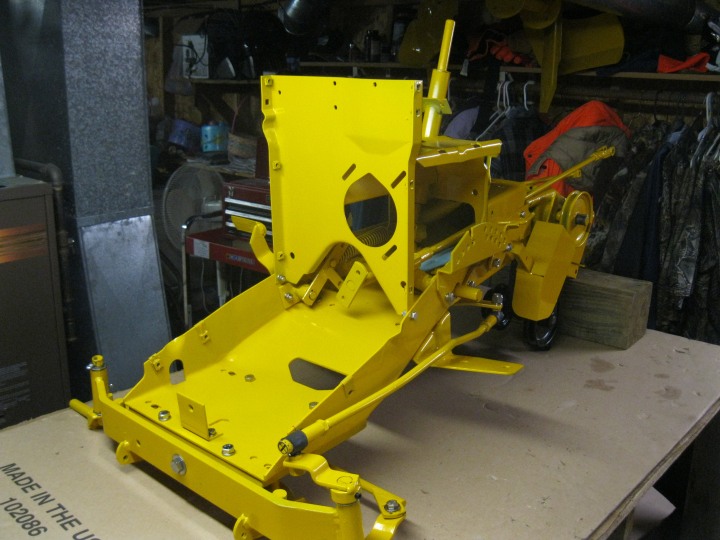

The paint is DuPont Imron 3.5HG from the DuPont Industrial Coating line. You mix it 4:1 with activator and thats it. It goes on thick and even and looks beautiful after it cures. When I first got done painting I thought it looked way too brown and the finish was terrible, after it cured it is amazing.
I have been to a few shows, I have seen about seven different yellows on the old B series. I don't think anybody knows the correct color, except for the one guy out east who has a brand new B-10 still in the crate.
What I did was took the paint from the inside of one of the side plates where the sun never hit it and matched that up. Perfect match or not, I like the color.
Heres the beast in the beginning
Currently,

Thanks once again Marv. I removed one of my gas tank straps which has good paint on the underside. It is a dead on match to your photo.
