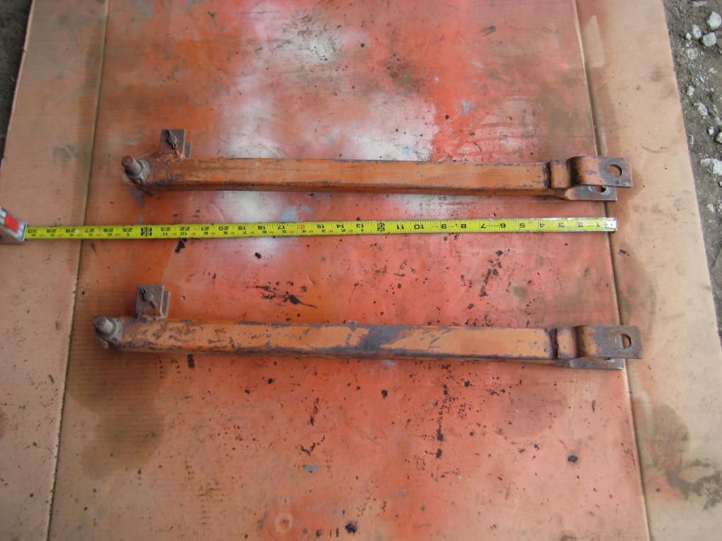

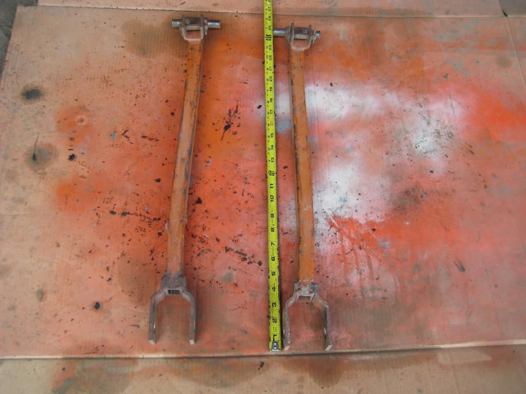

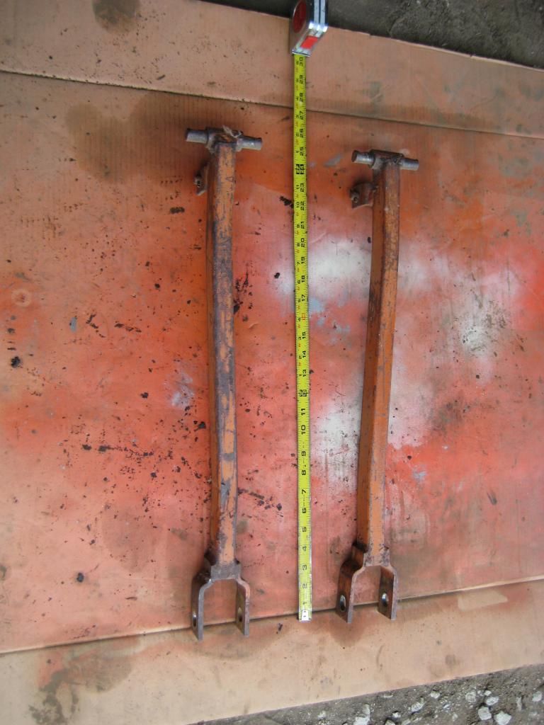

The two lift arms I need to make over, these are junk, besides farmer weld.Confused

I think there has been a previous discussion about the lift arms and I may have posted these before as I readily had the pictures, but here they are again. I have also experienced problems with the lift arms come out of the latches, especially if the ground isn't even. I tried using chains for the lift arms, but that allowed the rake to swing left/right too much and hits the rear wheels. It is a neat rake, if I could get it to function properly. Anyway, Ted asked for some pictures of the lift arms, and I don't know if PMing them worked, so here they are. Dave

Re the snap coupler lift arms, drill a hole, in the shaft, under the lower jaws, parallel to the top bolt of the existing SC lift arms, of the tractor's SC clamps, and insert a 5/8 bolt or round stock, like a AC bush hog has, and the arms won't jump out of the coupler...
Hope that made sense...
Points: 18943
Post Options Post Options   Thanks (0) Thanks(0)   Quote Ted J Quote  Post ReplyReply Direct Link To This Post Posted: 06 Apr 2017 at 4:41pm
Didn't help Dave as I've never seen a bush hog setup.... Thanks anyway, but do you have a pic?

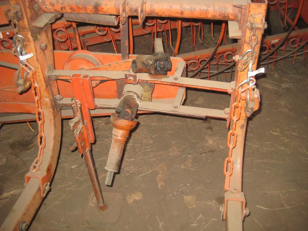

Ted, here is a picture of the front of my rake. Hope it helps with some of your questions. I don't have those four bolts you reference. I kind of suspect there may have been some sort of pto cover bolted on there, maybe? Can't tell from the picture about the other two holes, so will have to go out and take a look at the rake. The jack had been broke off of my rake when I acquired it, but did manage to find it in the seller's shed and then welded a bracket onto the rake to bolt the jack to. Dave

Ok, Ted, went back out and looked at my rake. The two holes you reference had a pin going through them to the bracket the idler/tightening pulley connects to. On your rake it looks like that pulley was moved to the left (as you face the rake) and a fabricated piece welded on for the pulley bracket, so I guess you have it taken care of. Hope this helps. Dave
