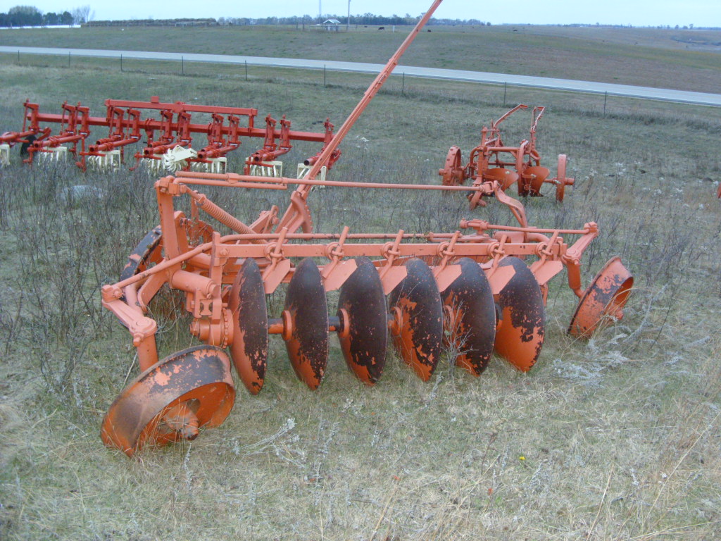

I found this while on a hunting trip out in North Dakota, the guy wants me to make him an offer on it and kinda wondering what I should offer him? it is in pretty good shape. needs a little tinkering. How rare are these?

That is a disc tiller. Still a great find at that. HTH Tracy Martin

I can't say that I have ever seen one of those, lots of disc plows but not one of those.

Disc tiller all of the discs are on one shaft
Disc plow each disc has its own shaft
That looks like the "Texas Beater model, but I am not sure"
Dont see to many of the rotary hoe's here in the north either, wouldnt mind trying one

Don:  i believe that is a Lilliston rolling cultivator in the picture.  Father in law had one several years ago.  Jim

It is a Lilliston.  My grandfather had that exact one for cultivating his produce crops. He died a few years ago and it likely went to the highest bidding scraphound at his sale.

yes that is a Lilliston cultivator in the background.

The tiller looks to be in decent shape.  Many of them are missing the scrapers, or they have been worn out.  Areas to look out for include looking over the castings for cracks and broken pieces (particularly on and around the lift gearbox), and also the disc shaft bearings.  In my opinion, the Athens castings of that time period were not of the best quality.  The iron is of fairly poor quality and has low tensile strength (which they made up for by using plenty of it) and is easily broken by carelessness.  The lift system is "unconventional" and if the springs inside aren't in good shape it can give trouble. Old dried grease will also cause problems, but ever since I cleaned mine out and installed new springs I have had no trouble.  My tiller is a four disc model, but I believe it uses the same spindle bearings as the six disc, so I should warn you that if you have to replace the tapered roller bearings, they are a funny (BIG) old size that has become very expensive.  I was quoted $300 plus for new bearings, so I turned out some sleeves and adapted some more modern but equally rated bearings for about half that money.  With new felt seals and discs, it now works great.  If you haven't used one in the field before, they can be a challenge to adjust properly in hard ground, but they can be adjusted to work very well.  Rarity seems to be a local thing with tillers.  They are not common in many areas, probably because of prevailing soil types.  If you really wanted one and it wasn't too far from home, it might be worth a few hundred dollars just for novelty value.

Seems like my cousins used to have something similar to that on the farm. Maybe it was over at my great-uncles place. Anyway, looks pretty nice. I like the 2 bottom in the background. I have one of those in Pennsylvania, if I ever get around to picking it up.
