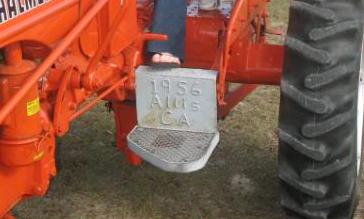

Anyone have a picture of an assist step mounted on a CA?  Looking for ideas on how to make a step to easy acces to a CA that I am trying to finsh.

This is the one I got from Roger Van Camp (260-747-3455).

Here is another angle of the one I also got from Van Camp.
Very hefty and bolts right into existing holes in the torque tube.

I guess I'll be needing something like that one of these days, but I will need it wide enough for both feet since I can only step up with my left foot. I wish the early B's had the torque tube bosses for that reason.

This is a step I fabricated for the B that works well.  On the CA, since it doesn't have a seat back to climb over, I just use the drawbar for a rear-entry step.

My Avatar is the step that I made for my D-10. 3/4 & 3/8 re rod.

A friend made this for me.  Still needs painting, but he did an awesome job.  I have better pics from home if you are interested.
