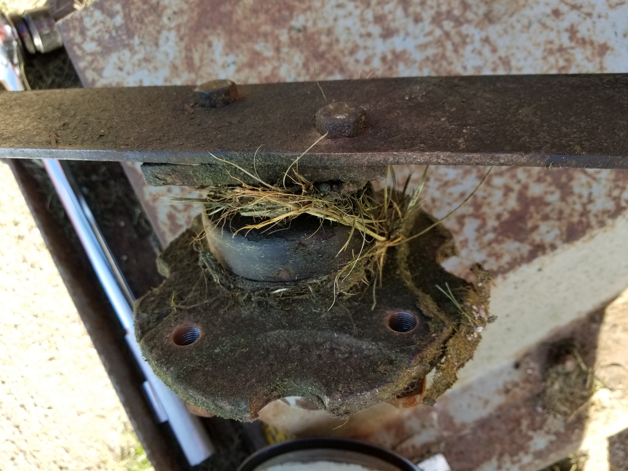

I have an Arts Way A372 72" belly mower on my Allis B. Everything was going great until I found a rock and snapped a spindle. Is there a source to find these parts? I can find blades and belts, but not a complete spindle. Or does anyone have a spare laying around? Thank you in advance for any leads!

Any chance the shaft can be removed and taken to Holland Repair to have a new one made?

You can buy belts from Artsway but all the mower parts are gone. I wanted blades and gave the parts guy all the information off the serial number plate and have never run into a more difficult parts person ever. He argued they never made a mower.

I emailed arts way but never got a reply yet..that's why I asked here lol. I guess I could always try to retrofit a different spindle from something else.

If you can find a local machine shop that does job shop work they can make you one using some 4140 shaft.
