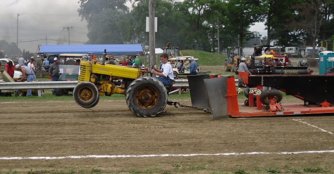

8 more hp than a G with 2 less cylinders, but weighs a little more. You can see how far I made it, not enough front end weight! I have no idea how much weight they had in the sled though.
