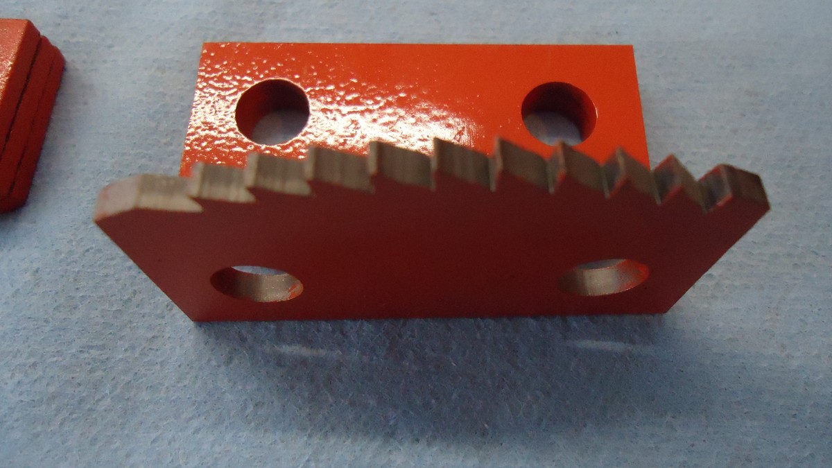

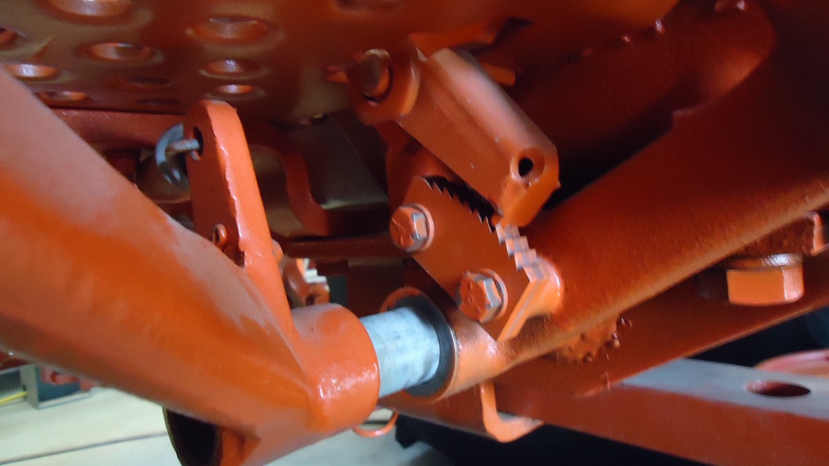

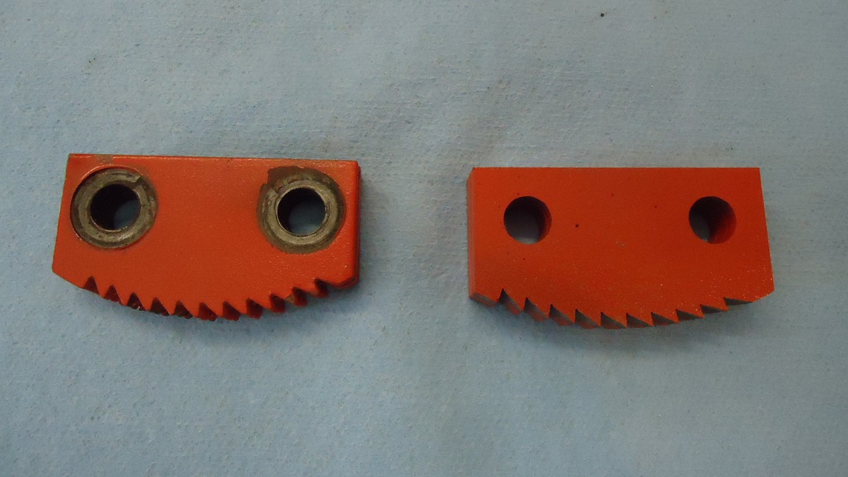

The brake ratchet & pawl were badly worn on my D17serIV.
I drew up the ratchet piece with 1 less cut than the original; 10 vs 11, respectively.
Had new ones laser-cut.  The teeth then became somewhat hardened.
Idea being that the cuts would be a little deeper.  Having 1 less cut didn't affect the function.
The pawl was re-pointed so that engaged fully.
Old vs New
deeper cuts on New
D17 Ratcheting Brake Lock a'y
and per Dr Allis,  adjust the bolt & jam nut so that the platform doesn't move/flex.
