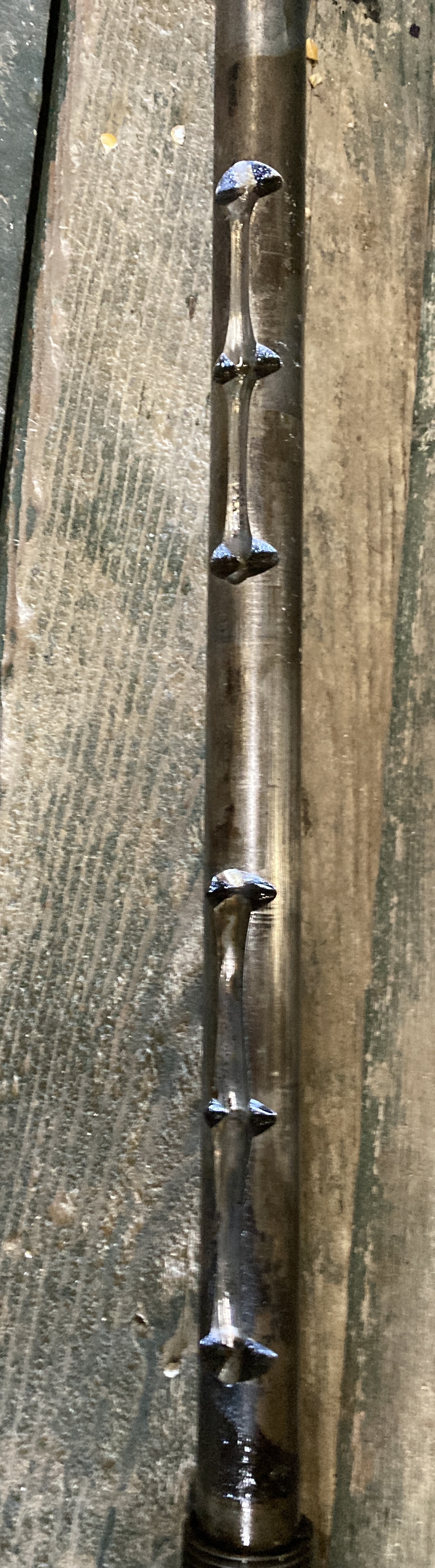

That’s a good looking ol’ machine. Thanks, i will check into the Jensales manuals. Main question i had was about the transmission shift rail… it has a groove running longitudinally between the detents, on both ends (each shift fork). We think the groove is part of the design, even though I haven’t ever seen that before on a shift rail that I can recall. One end is worn much worse than the other, and affects the functionality of the detents. Trying to decide the best approach as far as repairing or leaving it alone. The transmission got stuck in two gears at once and locked up, broke a couple teeth on one of the gears. The gear is getting fixed, but not sure about the shift rail.

That groove looks very uniform and has tapers by the detent notches. If I had to guess I'd say that's part of the design, and may function to keep the shift lever centered as you slide it back and forth through the opening in the quadrant. It is probably worn bigger than when new and made the detents shallower and not hold as well. It is very easy to get stuck in two gears, I find I have to let in the clutch a bit to get it to go into a gear detent about half the time. If you're careful it works fine though.
Edited by Bill_MN - 17 Apr 2024 at 4:32pm
