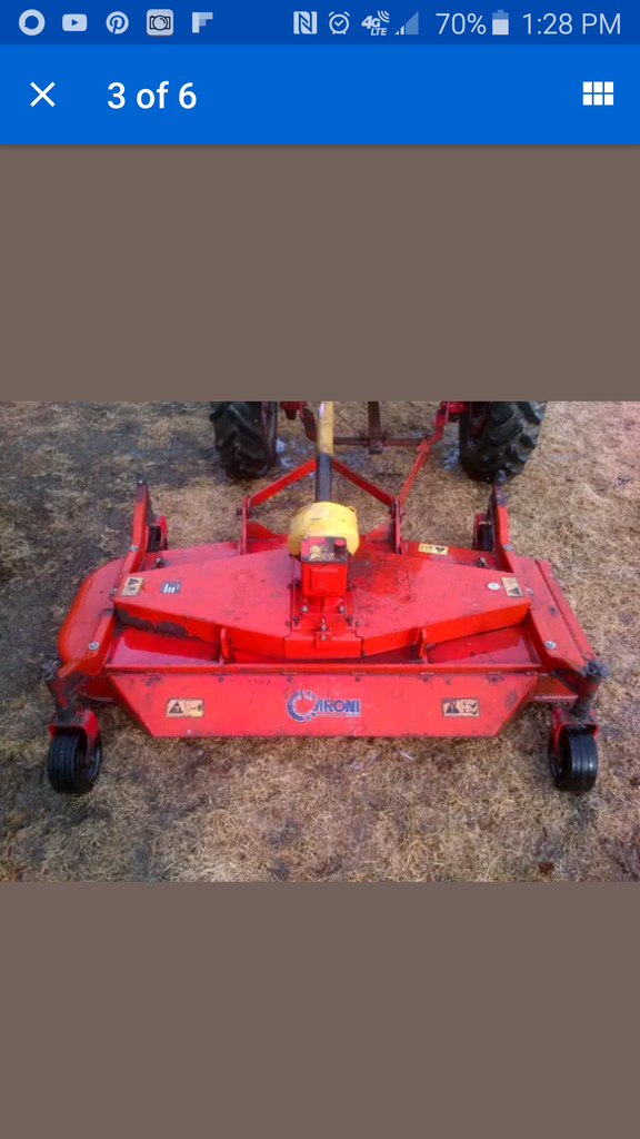

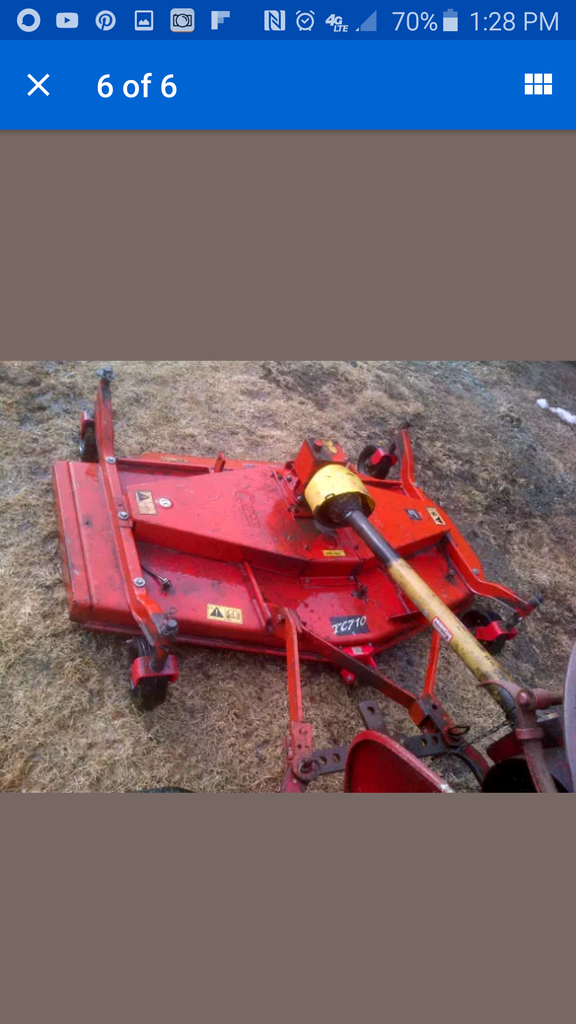

I though it was pretty neat. It be a lot easier to take off and on than the bell mower on the b.

Look like a farmall super A with pto on left side.

looks like a cobbled up mess. the 3 point tower was laid forward and a tongue hitch welded to it and the braces that should go back to stabilize the upright are laid forward to brace against the farmall hitch

look like the bush hog finishing mower
with the three blade
on a farmall cub with pto on left side

setup to cut offcenter to one side...Works good in some areas... Also the 3 pt use as a TOW BAR is a good idea since the tractor is too small to lift the deck with a 3 point....... basically a drag type mower.. .Probably works good in weekly / monthly mowed yard.

Yeah its a farmall supper A. I was on ebay looking for forks for my caroni finish mower and seen it. I just thought it be something that could be adapted to the b, only my mower a 5 ft and this one is a 6 so it would have to be inline with the tractor instead of offset. I was just wondering if anyone has actually used something like this? Iv seen a two of these set ups know (both was farmalls) one was a land pride and said it was a factory set up.
    Like I said it looks like it be easier to remove for using my b for something other than mowing. My 306 woods isn't hard to remove. It just takes me about 10 mins as long as I leave the brakets on the tractor, but it seems to take a while of tinkering with things to get it back to mowing just right.

I don't see a problem with it. I use a 6' farm King on my CA and never hook up the top link. So it just follows along behind. It's got 4 guage wheels just like the mower in the picture. I can't lift my farm King it's to heavy for the CA but follows along and mows just fine

I guess that's what you have to do without a 3 point hitch. It could be centered behind the tractor easy enough but it would put the u joints at a lot more angle.
