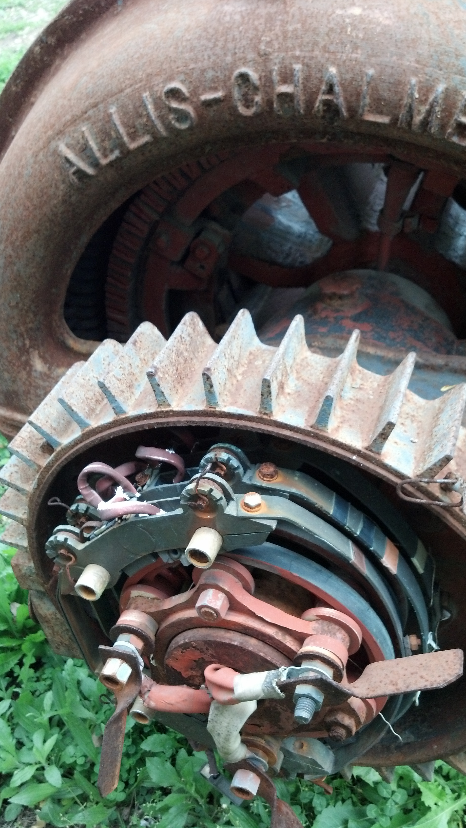

I have no idea what I have purchased.  Can anyone help me figure out what I have, and if I should scrap it or sell it?Mystery Allis-Chalmers

Looks like some kind of an Allis Chalmers motor connected to something like a pump (can't see it from here Wink )  Probably used in some kind of power plant or other process piping system.

the pump was a seperate unit.  here is a picture of the back

Looks like a DC motor / or / Elevator motor for lifting device

To me it appears to be a three phase generator, the giveaway is the three phase wiring from the rotor center and the brush assembly feeding the stator.  Most motors were not open framed but generators were.  Could have been from a phase converter plant the used 25 cycle AC to make 60 cycle AC or vise versa or even to change voltage from one source to a user level.  Would have had a motor/engine/turbine connected to the greasy shaft end.
