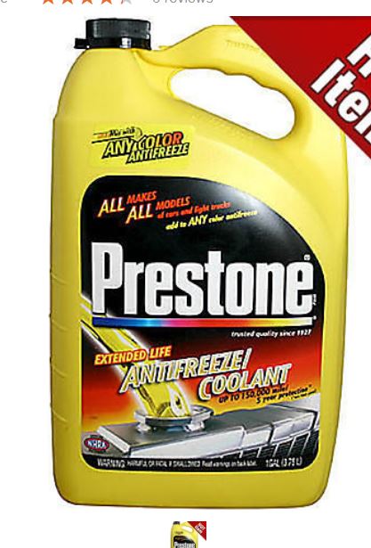

The ORIGINAL GREEN is from the 1950 - 1980 era.. BASIC antifreeze... Then they made the EXTENDED LIFE YELLOW to replace it... 5 years or 100,000 miles.. It is a DIRECT REPLACEMENT for the green........... That is your best bet.
In the last 20 years they have changed the antifreeze to various forms that are NOT COMPATABLE with the  GREEN or EXTENDED life YELLOW.. These would include  DEXCOOL and various forms of FOREIGN AUTO DESIGN... Dont matter what is claims on the bottle, they are NOT compatable with the YELLOW or GREEN...  Ever heard stories about someones antifreeze changing to Jello and screwing up the motor.. That is what happens when you mix DEXCOOL with GREEN/ YELLOW.
Just go with the "standard"  Extended life YELLOW and you are in good shape... If you prefer the older GREEN, that is fine, but it does not have the long life expectancy.
Points: 89178
Post Options Post Options   Thanks (0) Thanks(0)   Quote steve(ill) Quote  Post ReplyReply Direct Link To This Post Posted: 13 Mar 2021 at 8:44am
This is the good stuff... but i would NOT put it in a GM car with original DEXCOOL, or a new Foreign car.
