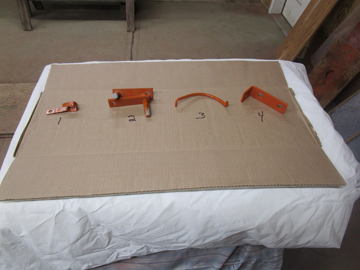

I can't figure out where this bracket goes on the tractor. Anybody on here know.
   Thanks Tim

It may be the clip that secures the fuel line and generator cable.
Don't know where it fastens; if it is that clip you might be able to find out by following the gas line and generator cable, looking for a handy 1/4" hole.
The one on my WD is long gone.

Well that's where I'll start. Thanks Brian.

It holds the wiring harness to the fuel line between the carburetor and air cleaner.

You mean the wiring harness isn't supposed to just drape over the petcock drain? LOL oops mine must be wrong
Just funny how few of these little items still exist after 70 years

I have a few tractors that have it still or otherwise i wouldn’t have known. Most are long gone.

Thank you Michael, I'll install it.  Tim

The model B's had a bracket like that under the drain cock dead center of the engine to hold the harness. Probably the same bracket used on all the models somewhere on board the Tractor...

I have a few more pieces I'm not sure where they go. The tractor at one point had a corn picker on it. Part #1 does not fit on engine drain cock. Part #1 is really the last part I feel, going back on.  Tim

Part #1 looks like a bracket that would support linkage or a rod or somethin'. Can't help ya on the other two.  Sorry.

Number one looks like the wiring harness clamp with part of the clamp missing. I have found number two on the inside of the frame rail to hold a loader bolt. Three looks like  the carb linkage that has been bent. Four looks like a cozy cab bracket.

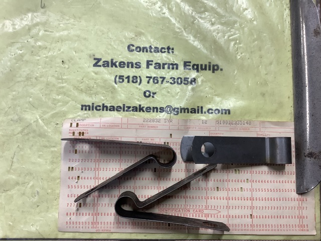

Would these be number one

I'm not sure if that's it Mike, but it looks like it. I was informed by a PM, its for a the steel hydraulic line going to the back. I'll try my piece tomorrow. Lonn that bent rod must be tempered. I can't even think of straightening it. And each end is a different size. Tim

That part number in the wd45 book say’s wiring harness ( for battery box)

 Number 2 comes with the mounted cultivator. Maybe other attachments also.

Thank you Nathan for that info. Mike I'll be getting in touch with you.   Tim
