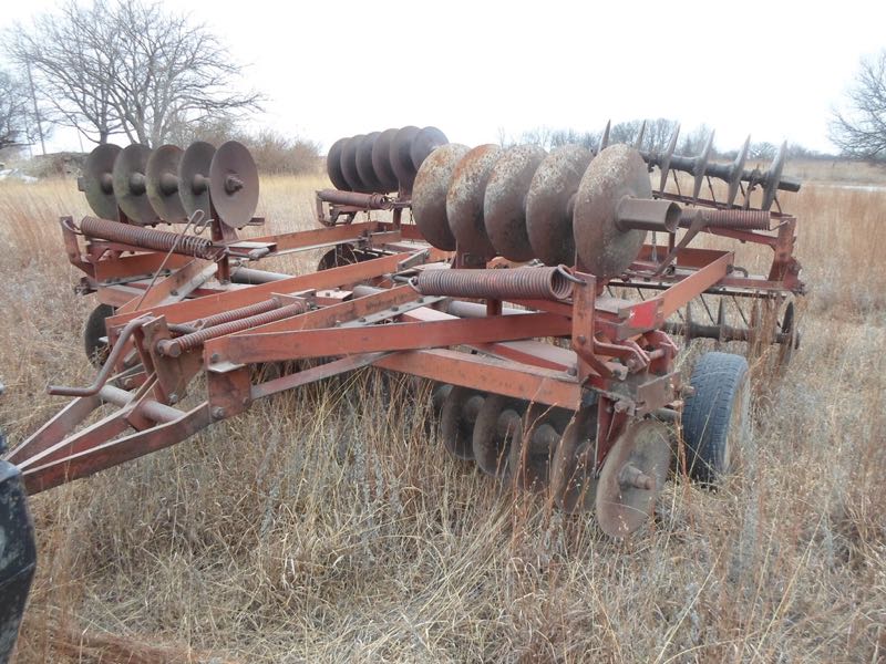

I just got home with the disk. It's probably a 17' since the wings are about 3' long. One of the wings is welded up, but I could care less as it looks pretty solid and I'm just pulling the wings off for spare parts anyway. 7.5" disk spacing and they're all in pretty good shape, and the bearings feel tight and smooth. It doesn't have a cylinder so I ended up coming home with it for $750. That might be a little high but this one's just way nicer than almost anything I've ever seen at a farm auction - and especially worth it if I don't have to spend time and money replacing bearings and disks in the near future.
Now will my WD pull it for finishing a seed bed, or will I need to buy a bigger AC tractor? Hopefully we'll find out next spring/summer.

You are going to know when you get there. Soils, hills, wet/dry, duals, weights on disk, or tractor all add up. If it won't pull it like you think it should then reduce the angle of the cut, make shallower passes or you could take a couple of the outside blades off, put in washers and make it more narrow yet. If none of that works, sell it or buy a bigger tractor...
Leon B MO View Drop Down
Location: Old Monroe, Mo
Points: 2206
Post Options Post Options   Thanks (0) Thanks(0)   Quote Leon B MO Quote  Post ReplyReply Direct Link To This Post Posted: 12 Dec 2020 at 6:18pm
I'm afraid you will have traction problems. Even just the base disc is too much for a 45. Add weight or wider tires or duals and you will still be short a couple of ponies to do a proper job of discing.
 Having said that, the best way many people on this site solve a hp problem it to buy a larger AC. A 170 or 180 gasser would pull your new disc. They are reasonable.
I honestly think you will be dissapointed.  Sorry.
