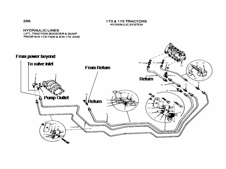

Here is a way for a 170 which would be the same.

Not sure what your thinking of doing, but you cannot plumb your existing 400 loader valve in-line with your chassis hydraulic system. You cannot make it "power beyond".  You can purchase a power beyond capable valve and replace the loader valve with it and plumb it to the tractors system. Or you can also connect two hoses to that loader valve to the outlets on the back of the tractor and turn on one remote valve so the loader would then function. Or, just eliminate the loader valve and use the two remote valves on the back of the tractor, but that will require four longer hoses.
