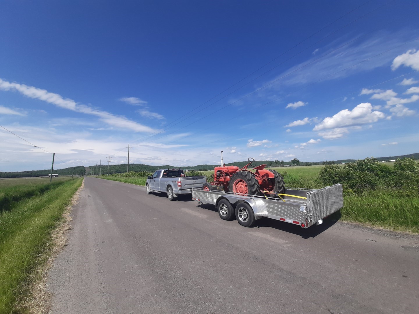

Something followed me home yesterday, LOL Another CA, a 1952.
So now I have a 52 and a 55. It runs really nice and has the larger tires on it. The farmer I bought it from has a couple other larger Allis's, including an untouched U that his grandfathers father bought brand new.
He bought the CA to pull a potato planter and picker, but found it was too fast.
It has 12 volt conversion, but is wired different than mine because it has a giant ballast resistor bolted on to the coil bracket. And I have to touch the two posts on the alternator to excite the alternator.
And the lift arms and belt pulley are gone. And no hand clutch. But the PTO works.
I'm going to leave it intact, but mainly bought it so that I have lots of parts in case something ever happens to mine.
