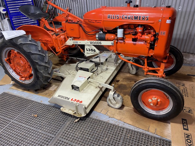

How many other folks can say they’re going to go mow around their hayfields today while attempting to break in their newly rebuilt 72 year old lawn mower?

I know nothing about those Woods mowers, is that a finish mower or is it more of a rough duty machine?

Not recently, although I did rebuild the engine in my CA/WOODS 306 about 4 years ago. People can have there rough riding zero turns if they want. I enjoy mowing about 6 acres of grass weekly.

I've got 2 CA mower combo's like yours. One narrow front, one wide. One for the home place and one for the farm. You got a sharp looking unit. Almost hate to see it get dirty.

Looks nice Dana! A great combo with the L306 on it. Ours mows a lot of yard at the farm. With good sharp blades it’s a good finish mower. We use a AC rider to do the trim work. Nice job

AC720 I now have two CA’s with 306’s. I too finish with an AC rider and wife runs 2 cub cadet v twins. I’ll sharpen blades 3 times a summer. Love em sharp! I had an injection in my meniscus surgery knee today and told to stay outta the shop for a couple days. I can’t wait to go remove the flywheel and remove that seal plate and then see what I have. Thank you all for inputs they’re like GOLD! Dana

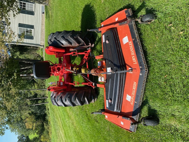

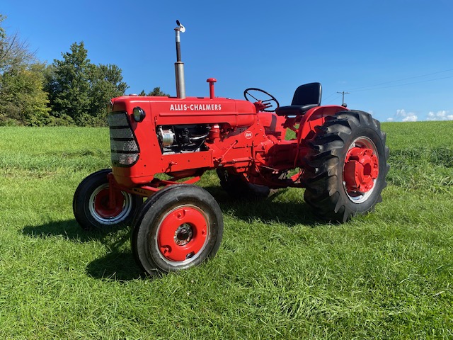

Almost forgot the newest addition to the lawn mowing fleet from this past fall. Its name is “the one that almost got away” because I thought it had factory paint still but when I got there I saw it had been done eons ago and had all those mole type growths all over it like fungus stuff. Literally I was leaving without…didn’t want another project…and then I reluctantly loaded her up as he about gave her to me. When her front tires hit the trailer ramps the hitch flew up off from the ball and dented the heck out of my Silverado’s tailgate. I had driven the 150 miles with the 2 7/8 trailer socket sitting on the 2” ball! Jeesh!, only “Chevy chase Dana” could do this!
