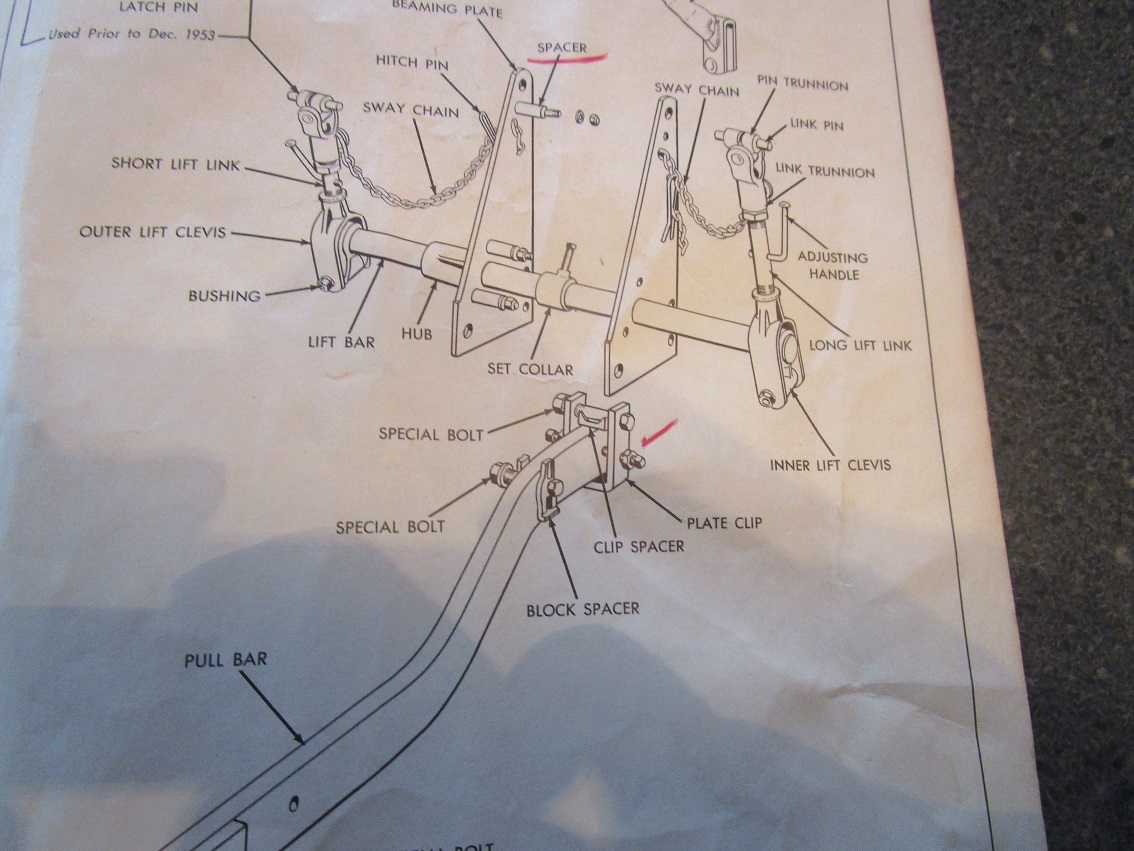

The pickup plow manual shows a spacer that goes on top of the rear end of the pull bar (spacer is missing).  In the line drawing, it seems to show it side-on as a straight piece of U channel with no cutouts for the through bolt in the sides.  However, in the image of the installation earlier in the manual, it appears to show the end view of the U channel as if it would need a cutout in the sides for the through bolt to go through (and presumably keep it from sliding out).  Not finding a suitable sized U channel, I'll probably make something.Does anyone know the design/dimensions of this spacer?  The max gap is almost exactly 5/16 inch so the web thickness would be 5/16 or less I assume.  I could also install it side to side so that the bolt goes through the channel, but that's not how the plow image shows it.

Picture is from my 52 plow I restored last winter. You can see the U bracket, its half inch thick. The plow goes on my WD. But I think the CA uses the same plow.

Post Options Post Options   Thanks (0) Thanks(0)   Quote Tim NH Quote  Post ReplyReply Direct Link To This Post Posted: 30 Mar 2026 at 2:38pm
Alright I see what your needing. The clip spacer is near the red arrow. I don't have one. But I'm sure someone on here does.

This is the CA manual depiction of the spacer.  Seems to imply it is installed horizontally, yet the actual plow image earlier in the manual shows an end view sticking out the back (like your image above) with the bolt going through the middle.  So I think this line drawing is incomplete and it has cutouts in all 4 sides/ends (or it was changed later).  I'm not sure it actually matters, but the below depiction of the line drawing of the spacer was confusing me when looking at the plow image.  I think a plain U channel with the bolt going through the channel will be fine.  I'd rather it be correct though.

I just received a 380 page plow parts manual.  It shows the two different spacers in question.  The one that looks like a plain U channel is PN 320358.  The one that looks like it has additional side cutouts is PN 320385 and is shown on the "snap coupler" version of the plow.  Mystery solved?
So I guess the "correct" one for my plow is 320358.  But presumably either would work.
Well, I guess not.  In looking further for the WD and the 2 way plows in the parts manual, they also show two different design depictions but all list the same 320358 part number.  So I think the 320385 part number for the CA snap coupler version is just a typo.  So maybe they changed the design at some point and didn't update the part number, or the plain U channel depiction was always wrong.  -OR- they failed to update the part numbers for the other plows...I can't tell.  Anyway, I have the material to make one if I don't find the correct one.
