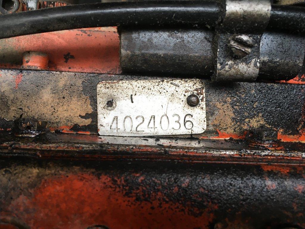

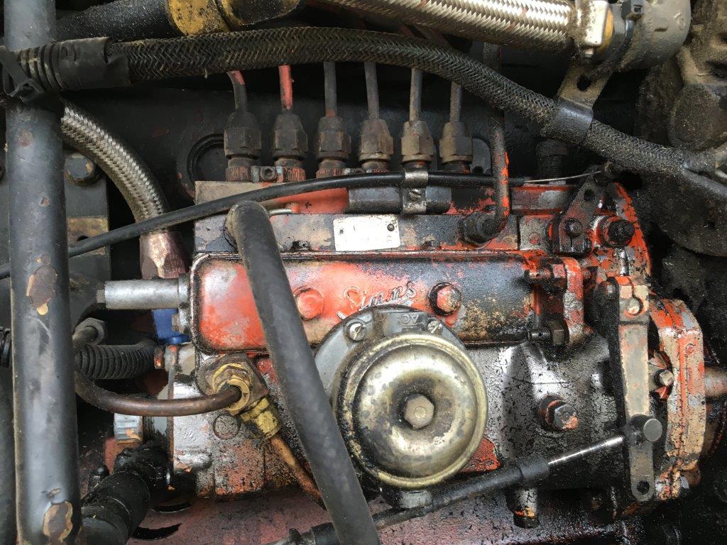

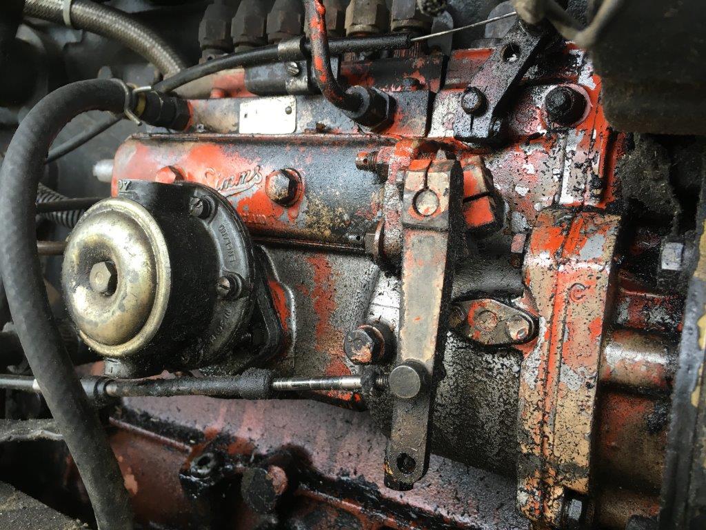

Here are some Photos of what I have.  The engine is all black, no green or yellow paint underneath.  Would the engine serial # help me ID it?
All engines for West Allis were painted with a primer that was called "buff green". It's a pea soup green kind of color.
On the engine ID plate it will give you the engine series number, the catalog number and the engine serial number. Using the catalog number you can break it down to the  group number (subassemblies) "IE" fuel injection group and from there you'll find the individual part numbers for each part from screws, nuts, injectors and the A C part number for the injection pump.

looks to me like it has an oil line coming from the engine. I don't have anything that shows what that pump number is for. According to one sheet I have, it's not an "L" pump.

Judging from the orange paint on the pump that tells me it's off of a combine engine. All of the engines that were shipped from Harvey to Independence (combine plant) were painted orange and had no primer color under the orange paint.

       there is a NOS Simms pump on ebay with that same AC model number.  The ebay description says it is from an "L", but who knows.
ACJack, I will get the engine plate number, but where do I get the info to "break it down to the  group number"?   The color under the black engine paint appears to be a light rusty red.

I added that AC number to my list. It shows the 4100 number being for a P5188A, timed to 30*. To help with your flutter, check timing, and may have to slightly advance it until it goes away, if it ever does. Engine flutters can be very difficult to track down since on a stand, I drive the pump, on the engine, it kinda drives the engine so to speak, so delivery valve hydraulic issues can also cause problems. Injectors getting low enough on opening pressure can cause it to worsen. Many people set injectors too low thinking they are doing good, but the nozzle can actually open and cause secondary injection between events. So check and adjust timing. Then check injectors again. Just because they were "redone" doesn't mean they were rebuilt correct for this application.

To break down the catalog number you'll need to get a "master "? Parts book. Maybe someone here has one.
All major castings had a red oxide paint on them. That could explain the light rusty red color.

Hey Ed! That gov is poor design and always worn(according to my pump guy).Can that lead to fluttering?

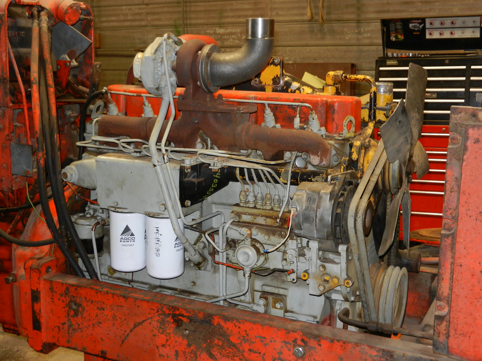

I don't want to hijack this post but only add to it. This is the Minimec (Simms) iinjection pump on the engine in my 220. It is yellow under the grey. I bought from an Amish fellow as a bare power unit but was supposed to have run a standby water pump in a town. It had 82 hrs. The manuals that came with the engine are correct for the engine but for on highway application. Injector orifice is listed as .375mm (.0148") which makes them the same as a 7080. Engine is a 3500 MKII and I'm guessing about 1974-5 by the design of the oil cooler. Pump tag is 4029107 and upside down on the same tag is P51841L. Engine is serial 3D-23396 Cat 4035113 with an additional number 1-7451-72818 on the data plate.
The yellow and black is the addition of the large waterpump and intercooler. With the factory pump settings the  tractor dynos 190 hp. (220 XT) I'd love to find out more about this.
about this.
If it's from 74/75 there's a good chance that I was the inspector who gave the final approval to ship it.
The 1-7451-72818 is most likely the purchase order number that the dealer ordered it through and that was stamped on the "long" data plate which listed all of the options that were ordered on it by the dealer. The standard engine data plate is about 3" long and the commercial engine data plate was about 10" long.
