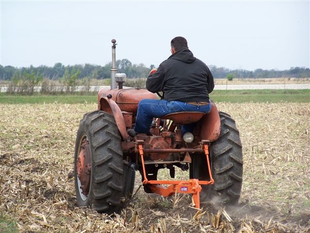

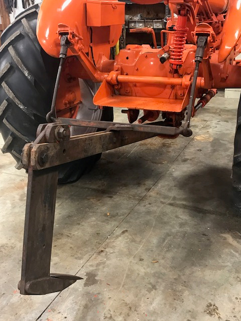

What model is subsoiler & did this model have a stand on front to match tractor snap coupler?
Stan R View Drop Down
Joined: 03 Dec 2009
Location: MA
Points: 996
Post Options Post Options   Thanks (0) Thanks(0)   Quote Stan R Quote  Post ReplyReply Direct Link To This Post Posted: 15 Feb 2018 at 5:15pm
Maybe an "optical illusion" but looks too close to the pto?
Points: 54704
Post Options Post Options   Thanks (0) Thanks(0)   Quote DiyDave Quote  Post ReplyReply Direct Link To This Post Posted: 15 Feb 2018 at 6:25pm
Might have the blade mounted up-side-down, looks like it might clear the pto better, thatta way...   Sorry, don't know the number, if it has 1...Wink

According to the Manuel I have, it is a #3 WD subsoiler made by Athens Plow Co. The pictured subsoiler in this picture is wrong. The cross piece that holds the two coupler links should be on top and the shank should be in the back hole. This would give more clearance at PTO.

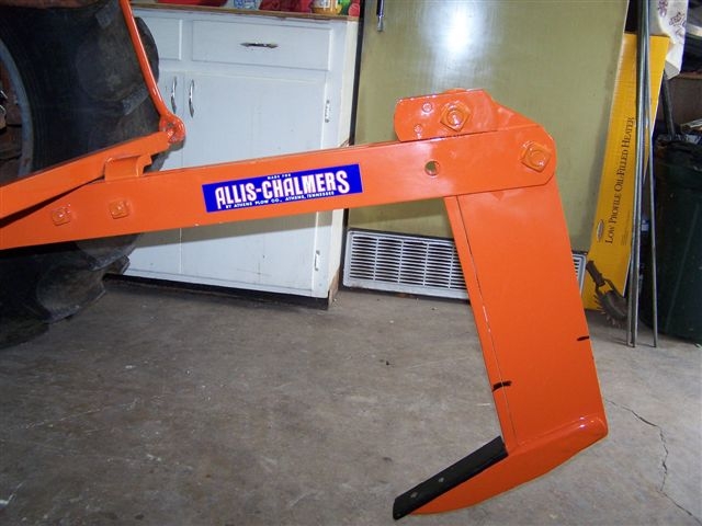

I believe Doug is right calling it a #3.  I've got a #4 which has a slightly curved mainframe to avoid hitting the PTO shaft.  In the first picture, I had removed the PTO shaft because I thought it might hit it.  It didn't, and I've since re-installed the PTO shaft.  The second picture shows how the cross-beam should be mounted (I believe...)

Thanks for the info, like that logo on your subsoiler. Headed to farm show in Louisville, when I get back I will put hitch on top & straighten both lift arms. Will solve hitting PTO shaft & will go deeper in ground.

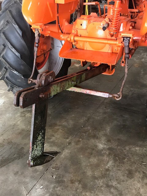

Post Options Post Options   Thanks (0) Thanks(0)   Quote R Albart Quote  Post ReplyReply Direct Link To This Post Posted: 21 Feb 2018 at 6:50pm
Straighten rods & put mount on top, PTO has clearance, paint when weather permits.
