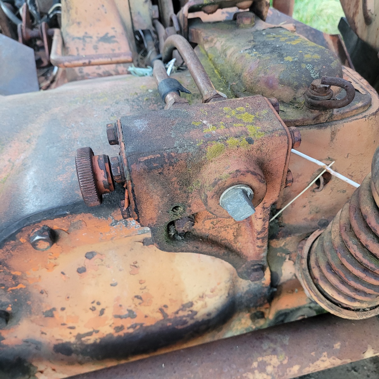

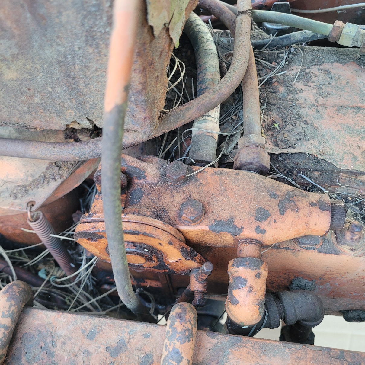

Does the allis wd have a hold position for the 3 point. Was trying to use the no5 mower and it was either going up or down.
I read on an older post that this has to do with the 3 point hold function?
