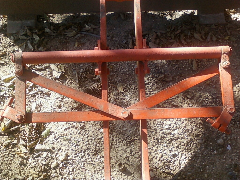

Bought a snap coupler blade without the lifting arms, (pic for example below) today.  Anyone have a parts blade or extra set theyd like to sell me?
Thanks
Steve

With some measurements, those could be made by a blacksmith pretty easily.

or one of the bigger plows, at a junkyard might be close...

Are you missing everything, or just the flat bits above the round bar?
I can get measurements from mine if that will help you.
Robert

All he needs is the lift arm latches that go on the tractor.

A piece of 5/8" rod welded to a 1 1/2" x 1/4" flat bar stock with a hole drilled in the end will do the job.

hmm..always wondered which WAY those things are supposed to go on, as they are 'offset' front to back ????

I have these ends if they help .U can take them off the rods .

Jay, in Fred's second pic, you can see the hump at the left side of the pic.  This is the side that goes into the snap coupler arms. You can tell by the top pic from Steve, the hitch eye is pointing at us.
