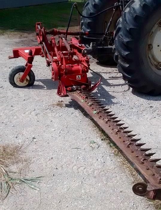

This is what it looks like. Only picture I could find online of one but no info. I assume the 80 series manuals are mostly the same, but I would like to find the right one or close to it.
Points: 8919
Post Options Post Options   Thanks (0) Thanks(0)   Quote Mikez Quote  Post ReplyReply Direct Link To This Post Posted: 15 Apr 2018 at 7:43pm
Yes that's an 82R. I just looked I don't have a book

Ok thanks. I’m sure the book will say, but what is the rear hitch for?

Rear hitch is for pulling a conditioner.
Points: 8919
Post Options Post Options   Thanks (0) Thanks(0)   Quote Mikez Quote  Post ReplyReply Direct Link To This Post Posted: 15 Apr 2018 at 8:08pm
Yup chad beat me to it. There was a pto stub bolted to back of the pully

I think that is an 82R3 isnt it? 82R was 3 point mount that raised and lowered with the 3point and had no tail wheel
82R3 had the tail wheel(semi mount) mounted to the 3 point, and raised and lowered with the cylinder

That's an 82R,the only R3 mower was the 80R3 the only true 3pt mower AC ever built.

I am looking for one like in the photo. It would be handy for doing the roadsides......

Theres brackets that go over the 3pt pins and go up to the center link bracket of tractor. Hope that made sense lol. But if i remember right they were a pain in the but to get in

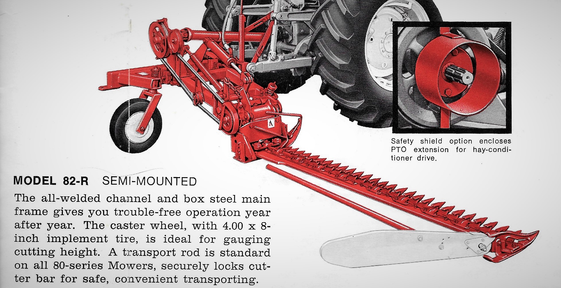

Model 82R Semi-Mounted - Picture from a sales brochure - shown is the PTO stub you speak of.

Yeah thats the one. The brackets going up to the center link bracket should lock it rigid so it cant raise or lower. On a D series tractor once you hit the raise lever it should send oil directly to the remote cylinder beacuse the 3 point arms would be lock solid.
Our Woods 3 point backhoe is set up like that. Once it is on the 3 point cant go up or down, it just hangs there lol
