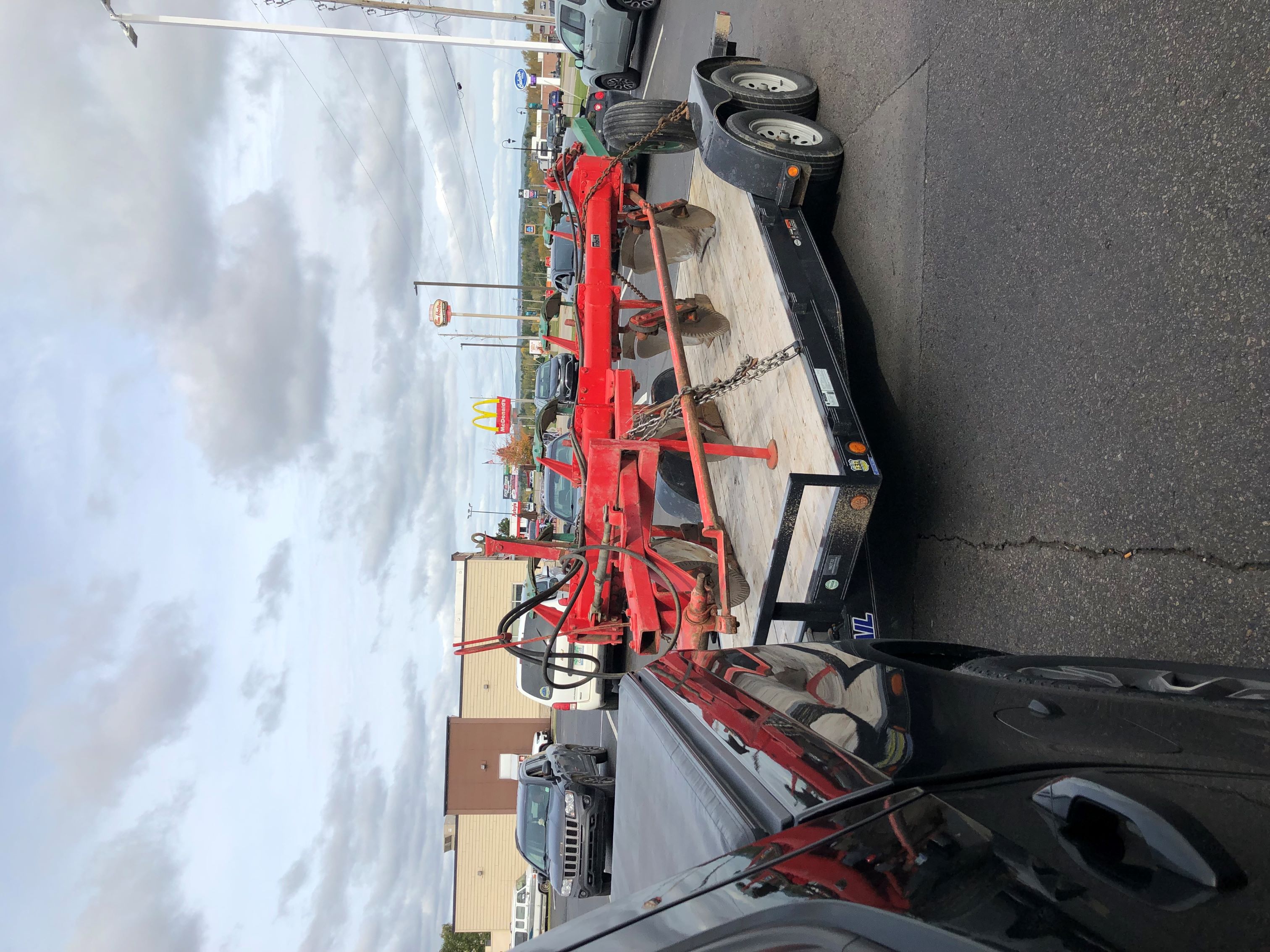

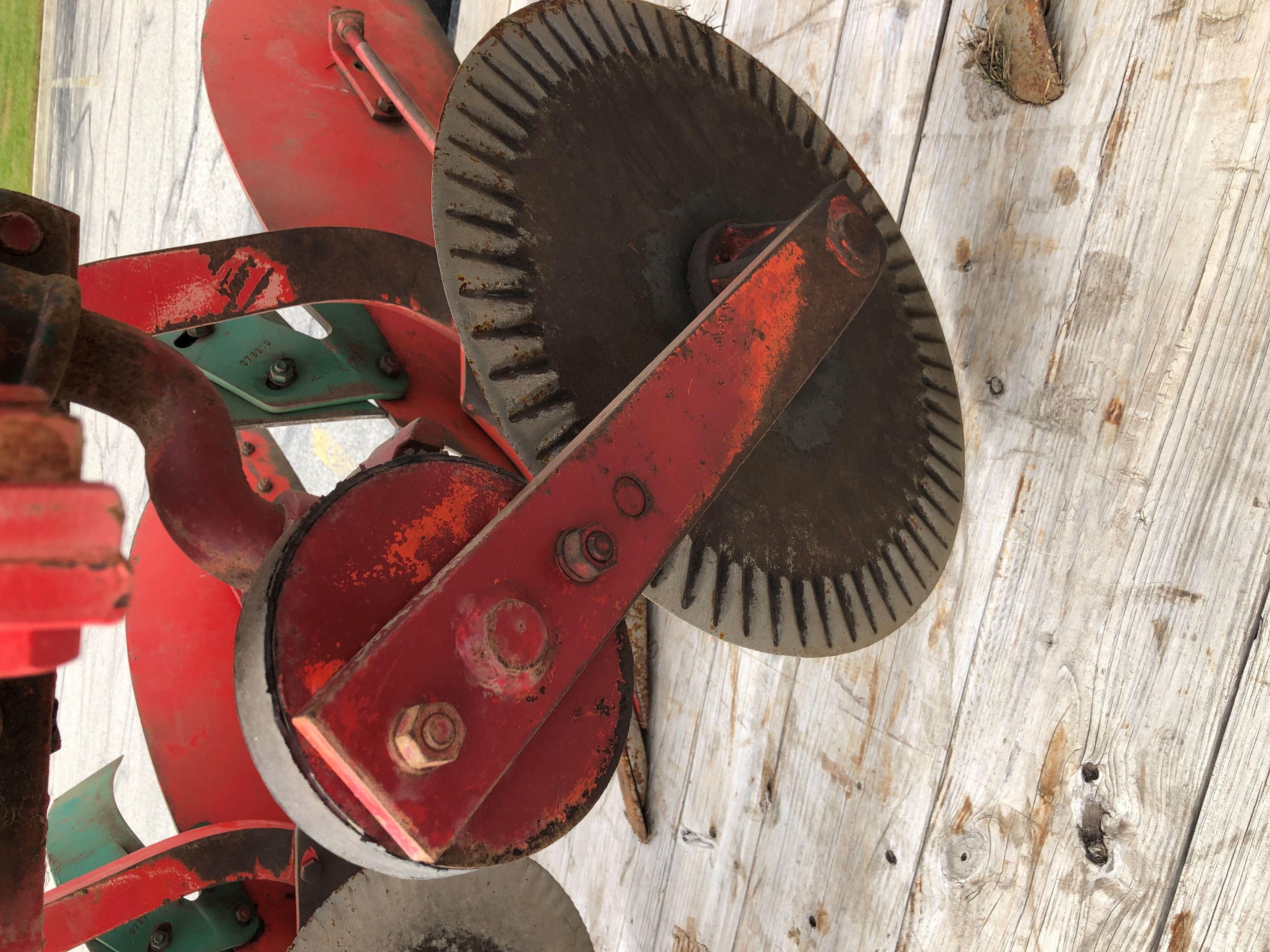

So i picked this up in an online estate auction.  I know the plow is good as we already use Kvernelands.  My question  is did the previous owner add the (I assume) Allis mounts and coulters or did he add them for rock issues?  Am I going to have problems with the mounts as they haven't been used in several years.  We are on heavy clay with not much for rocks.  I'm curious what I am in for.  TIA

Wow you never know where allis stuff will show up. The problem with them is the rubber gets old and just stop working and the blade just rides on top of ground. If you don’t have any use for coulters. Sometimes just cutting the sod in front of plow makes it roll over nicer.

Hard to say. When they tear, they tear and no good anymore.
