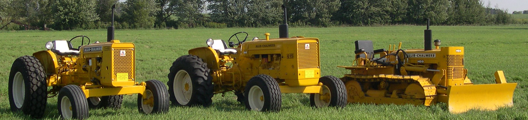

Post Options Post Options   Thanks (0) Thanks(0)   Quote Ages Cat Quote  Post ReplyReply Direct Link To This Post Posted: 30 Aug 2012 at 8:04pm
Ages Cat View Drop Down
Location: Hutchinson, MN
Points: 700
Post Options Post Options   Thanks (0) Thanks(0)   Quote Ages Cat Quote  Post ReplyReply Direct Link To This Post Posted: 30 Aug 2012 at 8:21pm
The HD3 is DAR 81985 Delstar. PPG no longer mixes that particular color , however. there replacement for it is Concept DCC 81657. This is Allis Chalmers construction yellow which was listed in the PPG manual years ago. There were several different shades, the earlier being less bright.  The wheel tractors are Concept (painted later), the crawler Delstar (DAR). Look under the fuel tank and match that color,  if you have an earlier HD3.
