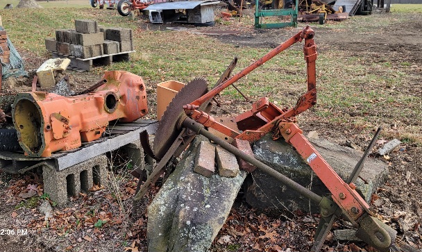

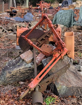

That is interesting.
I knew there was old and new style Fast Hich for IH but I never knew the difference.
Also I never saw a draft sensing draw bar for a Wd.
Isn't similar to the D and 100 series ?
I'll add photos of what I have.

I'll post photos of what I have.
But like most of the snap coupler equipment
The hardest thing is getting it hooked to the tractor.
Edited by Macon Rounds - 20 Nov 2023 at 11:31am
Points: 22799
Post Options Post Options   Thanks (0) Thanks(0)   Quote DrAllis Quote  Post ReplyReply Direct Link To This Post Posted: 20 Nov 2023 at 8:07am
The most common use for the Traction Booster drawbar was on a disc. It became part of the disc as a 3 1/2 ft pivoting extension of the tongue and had the snap-coupler eye and lifting links built into it. Before it was created, the disc was hitched very close to the tractor and you had to set the rear wheels clear wide to be able to turn on the field ends. This longer TBD attachment made your turns normal for shortness.
