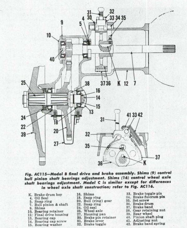

Hi all,
So on my b. The outter bull bear bearing went on me. I got it all apart new inner and outer bearings and races. New outter seal
My issue is the reassembly
Do you ba e the press the outter bearing on while it is in the housing being that the bearing will not fit past the outter seal?
How tight to I make the lock nut for the bull gear?
And I assume the inner bearing will be pressed in once all is back together
Alittle confused on the process. Thanks everyone
Points: 90602
Post Options Post Options   Thanks (0) Thanks(0)   Quote steve(ill) Quote  Post ReplyReply Direct Link To This Post Posted: 19 Dec 2025 at 9:34am
you push the outer cone into the housing up against the snap ring (22).. you put the cup ( inner race and bearings) onto the shaft...you push the  cone of the inner bearing into the housing against its snap ring.... you set the shaft into the housing... finsh install the bull gear and retainer nut as you push the shaft thru... tighten as much as you can... you might havhe to make a spanner wrench.... now install the inner bearing cone onto the shaft ... there are shims to adjust the bearing clearance/ back lash on the center BOLT that holds the bearing on.. if you tighten the bolt and the shaft dont turn smooth, then you  shim until it does... If you tighten the cap bolts and the shaft has too much end shake,  you change shims till it is OK.... now install the seal on the front of the housing.

I’m assuming this is all done with the wheel hub off the bull gear shaft?
I didn’t even look into removing the hub that would make a lot more sense
Points: 90602
Post Options Post Options   Thanks (0) Thanks(0)   Quote steve(ill) Quote  Post ReplyReply Direct Link To This Post Posted: 19 Dec 2025 at 12:53pm
yes, the steel wheel has to be removed... there will be a sleeve on the shaft that the seal runs on... Its make to replace the sleeve if the seal wears a groove into it..I have always been able to clean up the sleeve and reuse..  some of the wheels just fall off the shaft, some are very hard to remove off the 2 inch taper splines.. the outer nut is suppose to be in the 5- 600 ft pound range for torque...  200# man setting on a  3 ft bar.

How do I remove the hub from the shaft? I’m lost here
Points: 90602
Post Options Post Options   Thanks (0) Thanks(0)   Quote steve(ill) Quote  Post ReplyReply Direct Link To This Post Posted: 19 Dec 2025 at 7:15pm
normally when the shaft is on the tractor, yoiu beat the CRAP out of the hub with a 10 pound sledge... strike about 2/3 of the way out from the center of the shaft working at 3-4 spots around the circle.. Its a taper fit.. Once it moves 1/16 of an inch, i falls off... i would put the bull gear nut back on, wrap a nylon strap around the shaft and hang it from a rafter... with the wheel hub a few inches off the ground... smack the back side with the sledge.. If your lucky, i will pop off  with 4-5 hits... If your not lucky its a 3 beer job.
