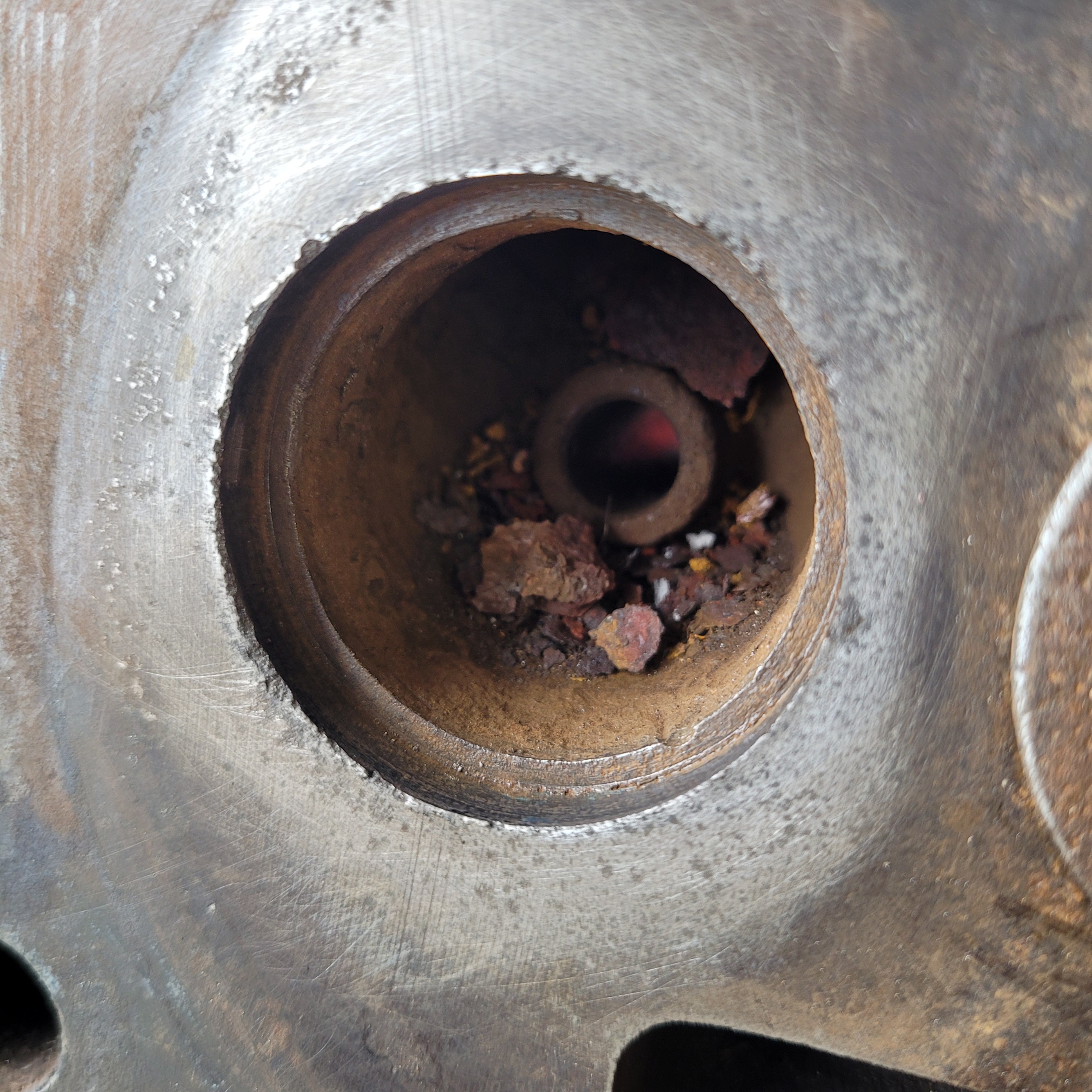

This may sound strange but did the engine in my 1949 Allis Chalmers WD have valves seats? Was the head itself the valve seat? Got an exhaust valve that the seat is almost nonexistent.

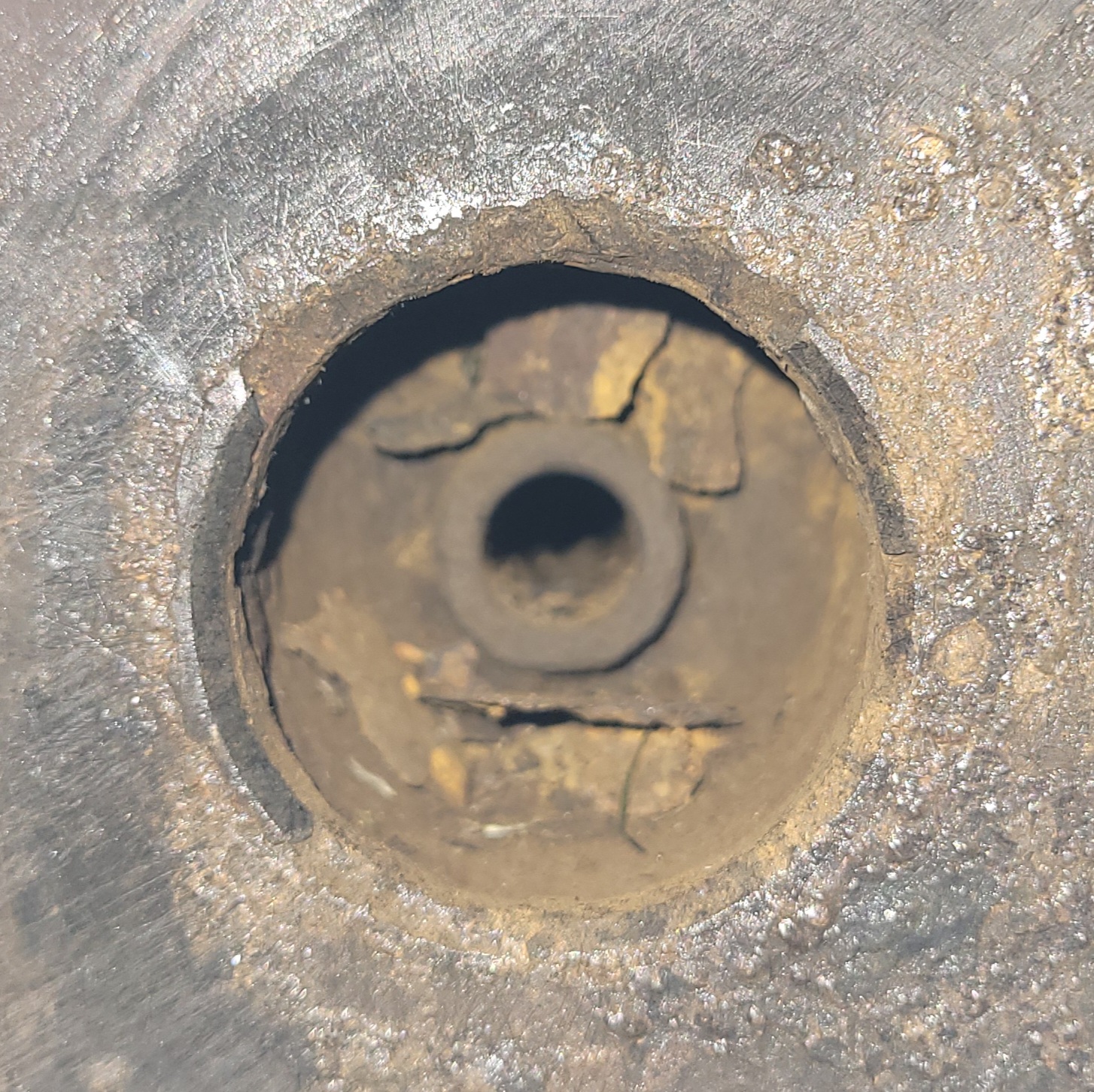

Are the exhaust valves seats for the WD known for being eaten away? I have one that is super super bad. All the others are normal. Does this one need to be pulled out and replaced or can it be fixed.
Points: 22789
Post Options Post Options   Thanks (0) Thanks(0)   Quote DrAllis Quote  Post ReplyReply Direct Link To This Post Posted: 06 Apr 2024 at 6:46am
Looks to me like an engine that has sat outside for 40 years without a rain cap on it and valve open. I doubt that it will grind smooth but you'll never know until you try.

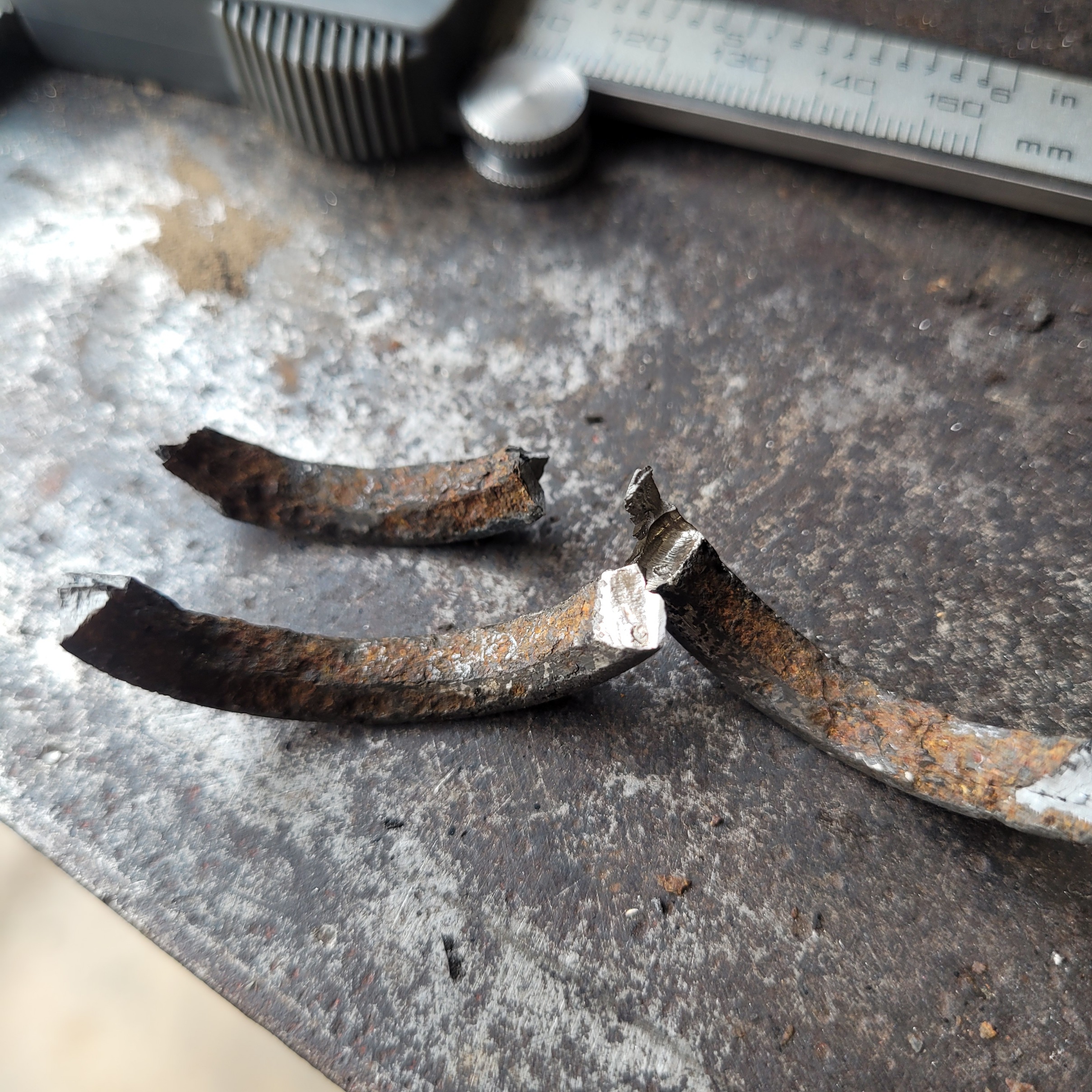

Alright got the old valve seat out! VERY VERY carefully used a dremel and made one spot really thin then used a flat punch with a lip ground in it as a lever on the inside edge of the seat and a hammer. Took some hits and a bit of heat but got it out!
Also does anyone have the part number for the Exhaust valve seat? The hole OD measures 1.5615"
Also Thank ya for the spec!

Post Options Post Options   Thanks (0) Thanks(0)   Quote SteveM C/IL Quote  Post ReplyReply Direct Link To This Post Posted: 06 Apr 2024 at 11:02pm
A couple 3 spots of weld on the ID will shrink em to make removal easier.

Post Options Post Options   Thanks (0) Thanks(0)   Quote tractorboy Quote  Post ReplyReply Direct Link To This Post Posted: 07 Apr 2024 at 1:54am
That's a good start ! I used the dremal tool trick last year on a ford Y-block, then slightly heated head pocket & used a correct size bearing tool to tap the new one in. I had the new one in the freezer for a day. Good Luck, keith so.va.

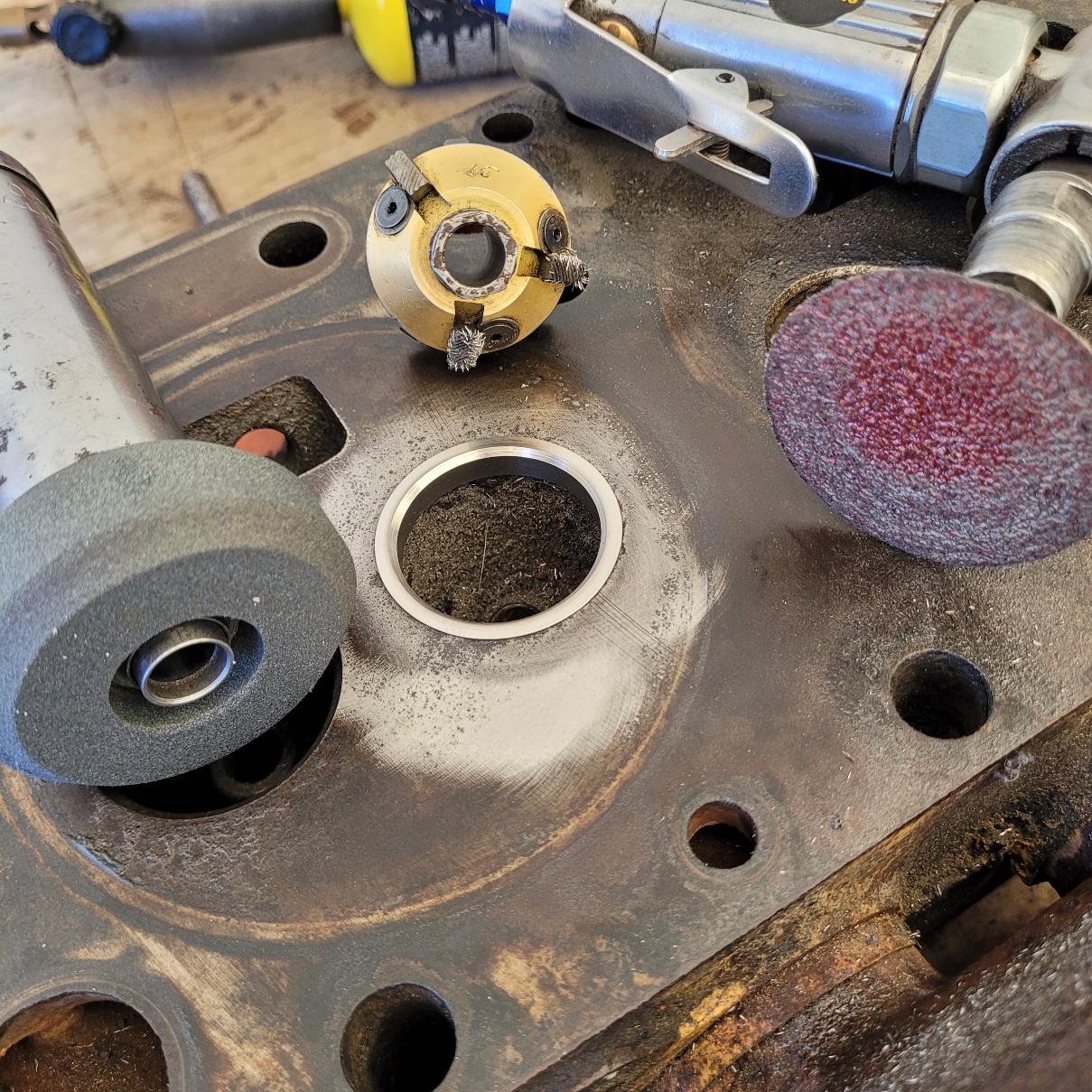

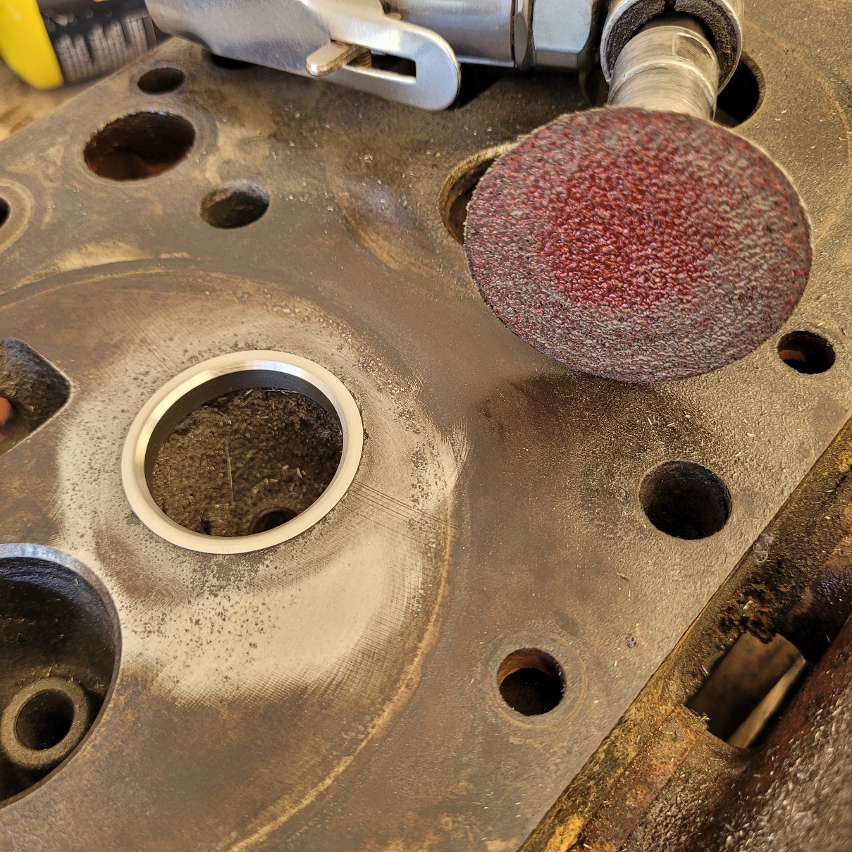

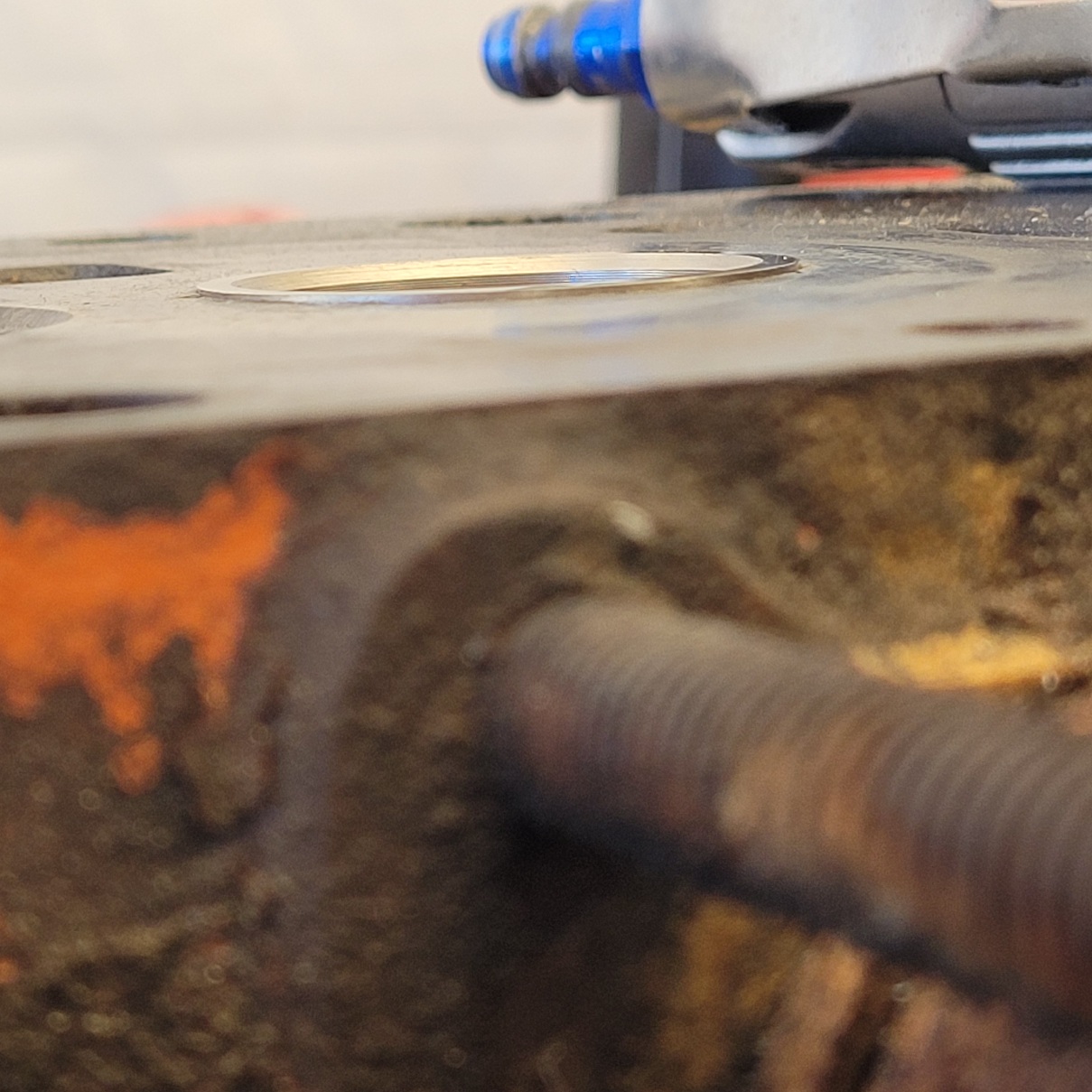

Post Options Post Options   Thanks (1) Thanks(1)   Quote ForgivenCreation Quote  Post ReplyReply Direct Link To This Post Posted: 23 Apr 2024 at 6:01pm
Well yall, it was a success!!!
I had to take about an 1/8" off the top once I got the seat in. With the seat froze in the freezer and the head at outside Temps the clearance was .015 took a couple taps to get it in. The stone was going to slow. To get the material off faster I used a 40 grit sanding pad, then the fine stone to true it back up and then cut the sealing face in. Still might stake it in. I did leave it sticking up off the surface of the head about .020 figured that would be ok.
