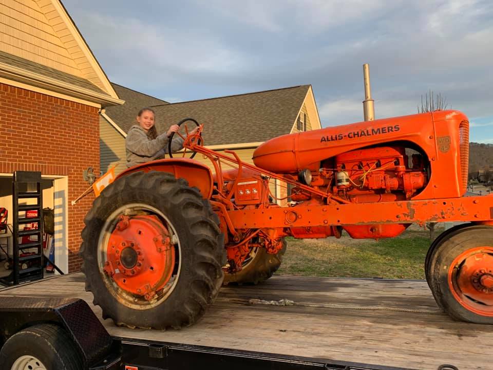

Hello everybody! I am new here. I just in inherited my Great Great Grandfathers 1948 Allis Chalmers WD. It is in decent condition for the age and ran just about a year ago. I have taken it fully apart, ordered new parts, paint, etc...
Couple of questions: (sorry in advanced if this is the wrong area for this)
1) I see in a lot of pictures a "pulley" or wheel looking thing off the frame on the left side (look at the tractor) - mine doesn't have that. There is a covered up hole where one would go I guess. What is this? Should I add this during the restore?
2) I took the front bumper plate off and there is all the steering gears and some nasty oil or gear oil or something in there. Hardly any in there currently. - QUESTION - What "oil / liquid" do I use and How much do I fill this up? (Again, front plate which is covering the steering gears and the manual crank rod/shaft)
Thank you all again! Any answers and advice for me would be greatly appreciated. Hoping to get it looking back to its glory and keeping passing it down for many more generations to come! :)

That is where a belt pulley would go for powering feed mills, thrashing machines, saw mills. I like any tractor that has one and I also added it to dads WD45 when I restored it.
I believe the weight of oil that is supposed to go in the steering gear area is something like 160 weight or about like pancake batter but don't quote me. Some will just pack it with grease as the old seals don't hold the thinner stuff in very well.
Hope this helps.

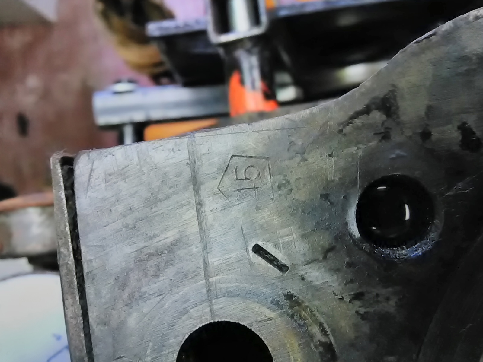

Thank you for the great information, the more the better.I took the head off and there is a 45 inside what looks like a Chrysler emblem (pic to follow) on top of the block deck. Very intriguing.

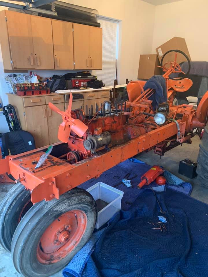

Thanks for all the reply's. The I am trying now to grind off the old paint and wash off all the crud and grease from the hydraulic system leaking over years and years. About to remove the back hydraulic arms and hoses. Starting to get tedious, but I know the end result will be AMAZING! Here are some pictures from yesterday. I have some parts on their way. New manifold and studs. New Radiator, New WD decals. (not WD-45 which is on there). New Allis Chalmers paint. New gaskets all the way around and New belt!
Need to figure out if I can reuse the Carburetor and the old 6v Generator. :)

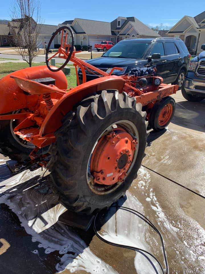

Updated Picture as well:

Measure the cylinder sleeves. Are they 4 inch?? or 4 1/8" ??

I'm pretty sure that head sittin' over there on the bench is a "short" head which would
be correct for the early WD engine.

Thanks for sharing the progress pictures! Yep sure looks like a WD! Could still have a WD45 crank in there!:) Check your stroke. 4 inches = WD, 4.5 inches = WD45!

Wow! Look at the nice tires,too! Good luck with your project

For all who were wondering, I just checked and 4 inch cylinders! I removed the head lights today, the housing that holds wiring and the starter.

4 inch pistons that are a "flat top" are WD pistons and should have a 4 inch stroke. If the 4 inch pistons are "dished", it probably has a 4 1/2" stroke making it a WD45 short block.
