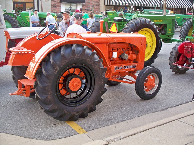

Hood and rad are interchangeable with unstyled WC,  Spoke wheels were used up to past that number, I had WF502 and it had spoked wheels.  Many parts are WF specific.  Mine had bad fenders but I had a bodyshop friend use the fenders off a WC and cut them down and refit them to the inner pannel from the WF. Steering wheel is different on the WF as well as the rest of the steering components including axle hubs and front wheels. Seat and backrest are same as Wc but the support spring is shorter (not interchangeable).  Other parts also just can't remember now, HTH's

Round spoke 24 inch rear wheels would be correct unless they are flat spokes. Then that would suggest that they were cut-down steel wheels. The sheet metal should interchange with a WC except for the rear fenders.

According to Allis-Chalmers data book, (page 47) the rear wheels had 24 inch tires and round spoke-type prior to serial number 204. From serial number 204-1903 they were disc-style wheels

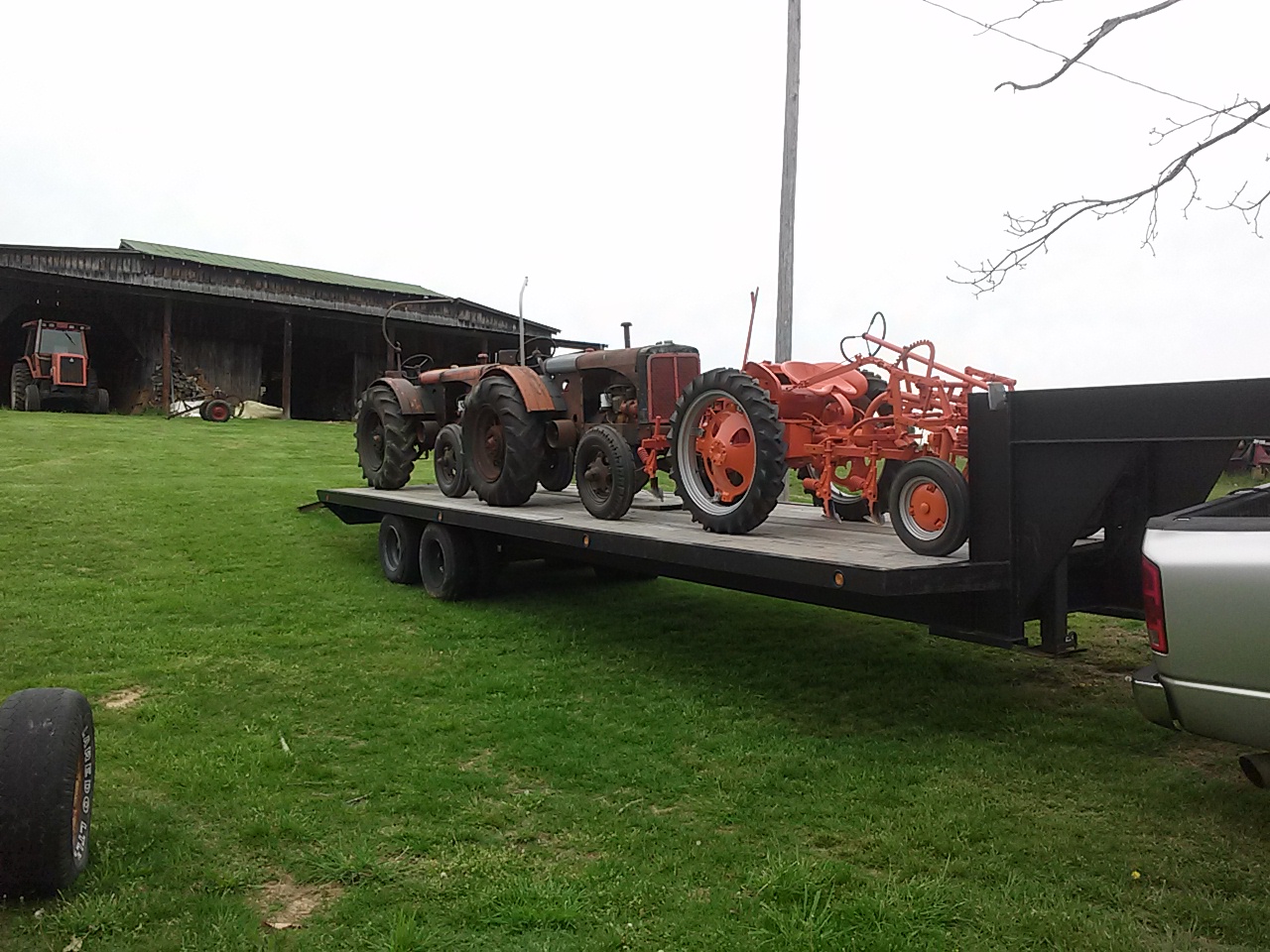

The hitch is not the same. Just assembled sn 9xx and11xx using WC parts. Sounds like all you need will be a WC doner.
