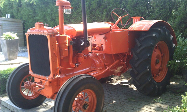

Post Options Post Options   Thanks (0) Thanks(0)   Quote Wot Quote  Post ReplyReply Direct Link To This Post Posted: 17 May 2011 at 7:08am
Hello Fred,
Sorry for my late reaction.
Here are some more prictures of our U.
She isn't ready yet.... there are some little things to do!
Edited by Wot - 17 May 2011 at 9:02am
AC: B / WD / CA / WC unstyled / U / 7060 / 710
Rfdeere View Drop Down
Location: Idaville, IN
Points: 3283
Post Options Post Options   Thanks (0) Thanks(0)   Quote Rfdeere Quote  Post ReplyReply Direct Link To This Post Posted: 17 May 2011 at 11:33am
   That's a beauty for sure ! Great Job !
