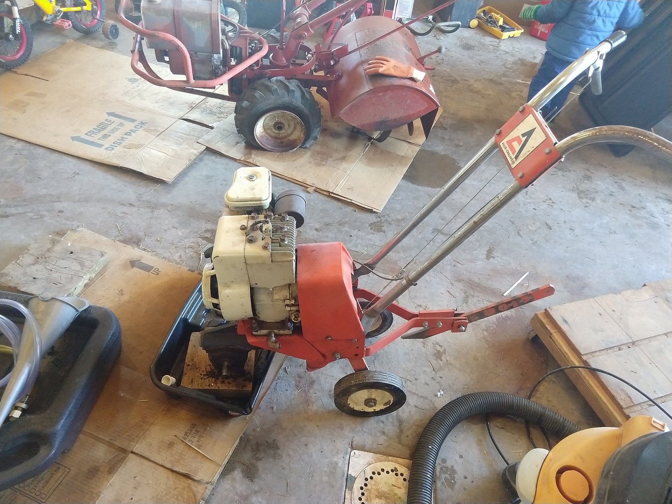

welcome to the forum. Have any pictures

It is a work in progress, I will probably post some more once I get this cleaned up and put back together.
Points: 5469
Post Options Post Options   Thanks (0) Thanks(0)   Quote AC720Man Quote  Post ReplyReply Direct Link To This Post Posted: 27 Mar 2022 at 8:17pm
Looks like it’s in good shape. Owner took good care of it.

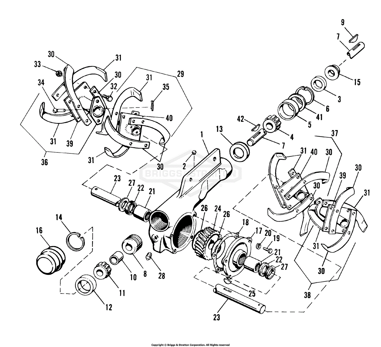

Ok, next question. I need to replace the drive shaft oil seal, which is part #3 in the diagram. But that is under the shield (part #15) and I cannot get under the shield to pry it out and get at the oil seal. I am thinking the shaft would have to come out first (tine shaft and gear is already out). So, which way does that drive shaft come out? The parts diagram makes me think it come out the back. Anyone disassembled a gear box like this have any pointers?
